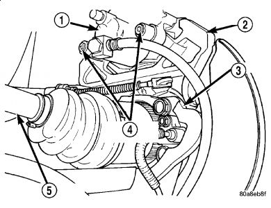

how do you remove rear pads and rotor

DISC BRAKE CALIPER - REAR REMOVAL REMOVAL - REAR DISC BRAKE CALIPER NOTE:Handling of the rotor and caliper, must be done in such a way as to avoid damage to the rotor and scratching or nicking of lining on the brake shoes. Raise the vehicle. Remove rear wheel and tire assembly from vehicle. Remove the disc brake caliper to adapter guide pin bolts.
https://images.2carpros.com/forum/automotive_pictures/99387_Graphic1_612.jpg
1 - DISC BRAKE CALIPER 2 - ADAPTER 3 - AXLE 4 - GUIDE PIN BOLTS 5 - DRIVESHAFT (AWD MODELS ONLY) Remove rear caliper from adapter using the following procedure. First rotate front of caliper up from the adapter. Then pull the rear of the caliper and the outboard brake shoe anti-rattle clip out from under the rear abutment on the adapter. If the brake rotor requires removal, it can now be removed by first removing the retainer clips from the wheel mounting studs, then pulling the rotor straight off the studs
