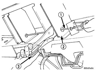

How do you take off the rear drums on this van. There isn't any wheel to make an adjustment for losening the shoes. Do you have to loosen the 4 nuts at the back? Thanks for any help you can give me.

Slacken parking brake grab exposed cable pull down clam vise grips to hold see diagram
https://images.2carpros.com/forum/automotive_pictures/198357_Graphic_648.jpg
