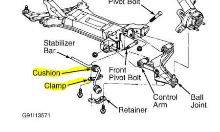

BMRFIXIT
  • 19,053 POSTS
https://images.2carpros.com/forum/automotive_pictures/99387_Capture_18.jpg
Sway bar links and bar bushings is a very common its not a safety issue where you have to jump and do it right away but need to be done soon and when you can
