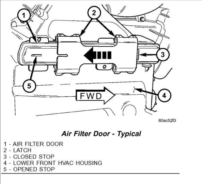

Hi, I have been trying to locate the cabin filter but to no avail. Had seen the diagram posted on 2CarPros, however, I still cannot figure where is the filter.
Can anyone there help me? Possible to provide a photo on the location. Thanks

Hello, Not all of these cars came equipped with cabin air filter, FYI. 1. Locate the air filter door on the bottom of the lower evaporator housing just outboard of the passenger side of the instrument panel center stack. 2. Slide the air filter door latch toward the rear of the vehicle until it engages the opened stop on the door. 3. Pull the air filter door latch straight downward to disengage it from the air filter opening of the lower evaporator housing. 4. Use your fingers to reach through the air filter opening of the lower evaporator housing far enough to grasp the air filter. 5. Pull the air filter straight down and out of the evaporator housing.
https://images.2carpros.com/forum/automotive_pictures/99387_Graphic1_511.jpg
https://images.2carpros.com/forum/automotive_pictures/99387_Graphic2_251.jpg
Here is a guide to show you what you are in for when changing the cabin air filter: https://www.2carpros.com/articles/how-to-change-an-air-cabin-filter Here are some diagrams (below). Please let us know if you need anything else to get the problem fixed. Cheers, Ken

I have the general idea on how to locate and change out the cabin air filter on my van. For the life of me, I cannot find the latch, door or release tab that will open the filter compartment and permit the filter to be pulled down for replacement.
Is it possible that despite the reference in the owners manual to the filter replacement process? There really is no filter to change.
Does anybody have a good closeup photo or line drawing of the assembly showing just where to push or pull what?

Is your vehicle equipped with the automatic climate control system? If not, there is no cabin filter. If there is a filter then there will be a visible latch to slide on the filter housing.

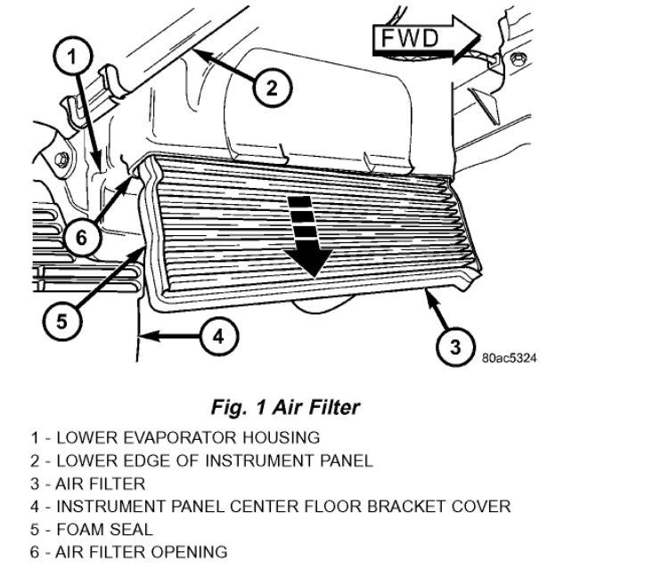

  • 75,988 POSTS
Fig.1 air filter
https://images.2carpros.com/forum/automotive_pictures/12900_caf_2.jpg
The cabin air filter access door is located under the instrument panel on the passenger side. https://www.2carpros.com/kpages/auto_repair_manuals_alldata.htm

Locate the air filter door on the bottom of the lower front HVAC housing just outboard of the passenger side of the instrument panel center stack.
Pull the air filter door straight downward to disengage it from the air filter opening of the HVAC housing.
Use your fingers to reach through the air filter opening of the HVAC housing far enough to grasp the air filter.
Pull the air filter straight down and out of the HVAC housing.

My 2004 Grand Caravan with manual A/C controls did not have a cabin filter, but it does have the shape of where the filter would go if it would have had auto-A/C. So I used a dremel tool to cut open the slot (its about 9 1/2" x 1 1/4"). I smoothed the edges and slid a FRAM filter in. I might go to an auto-recycler to get the proper cover, but for now I am using duct tape to cover the opening.
