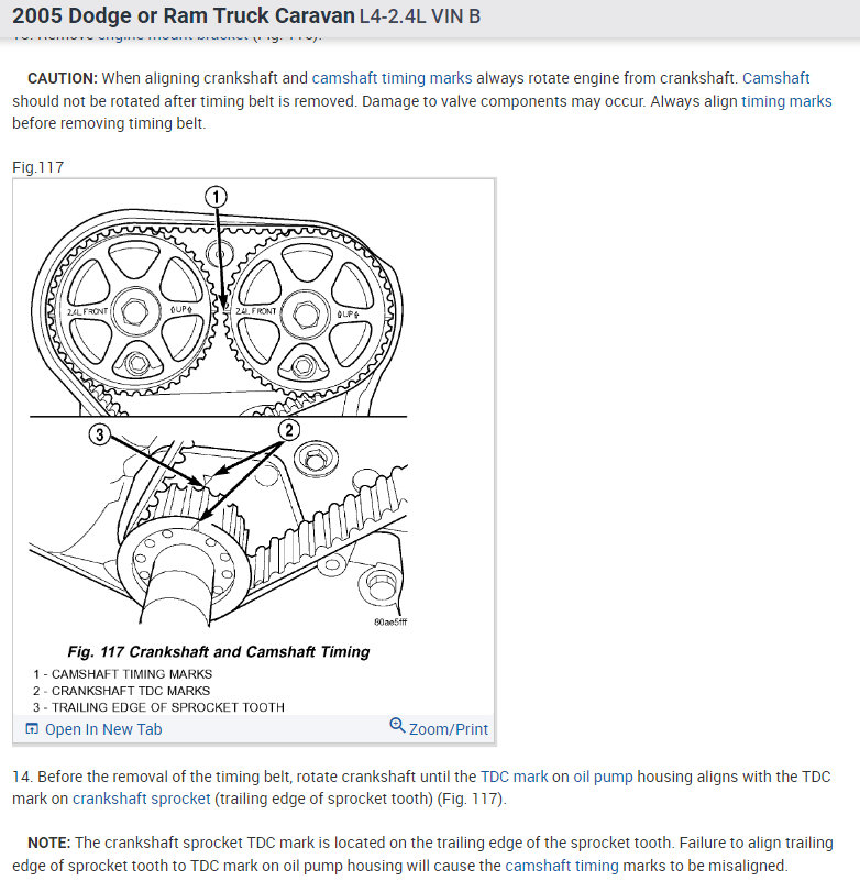

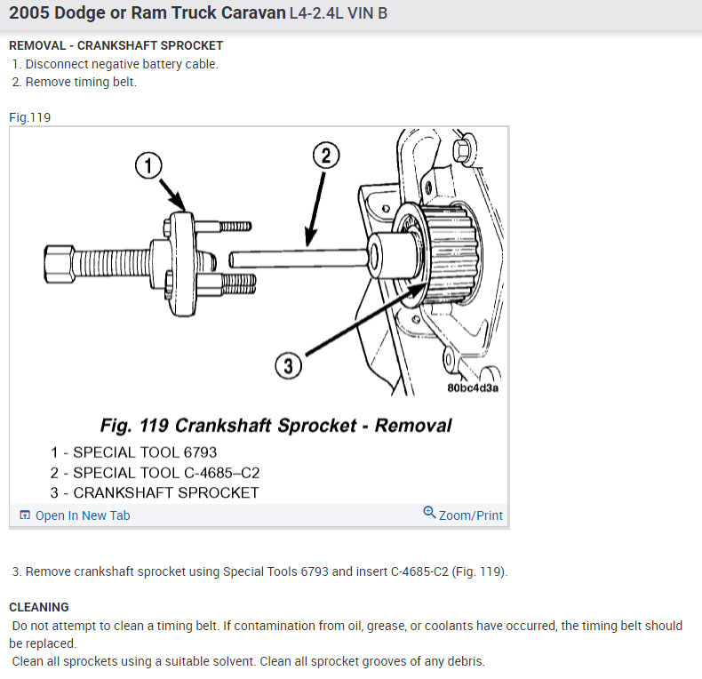

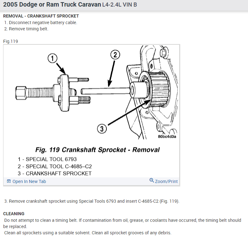

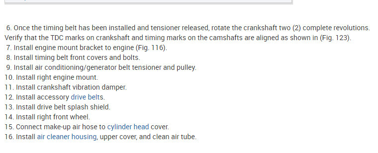

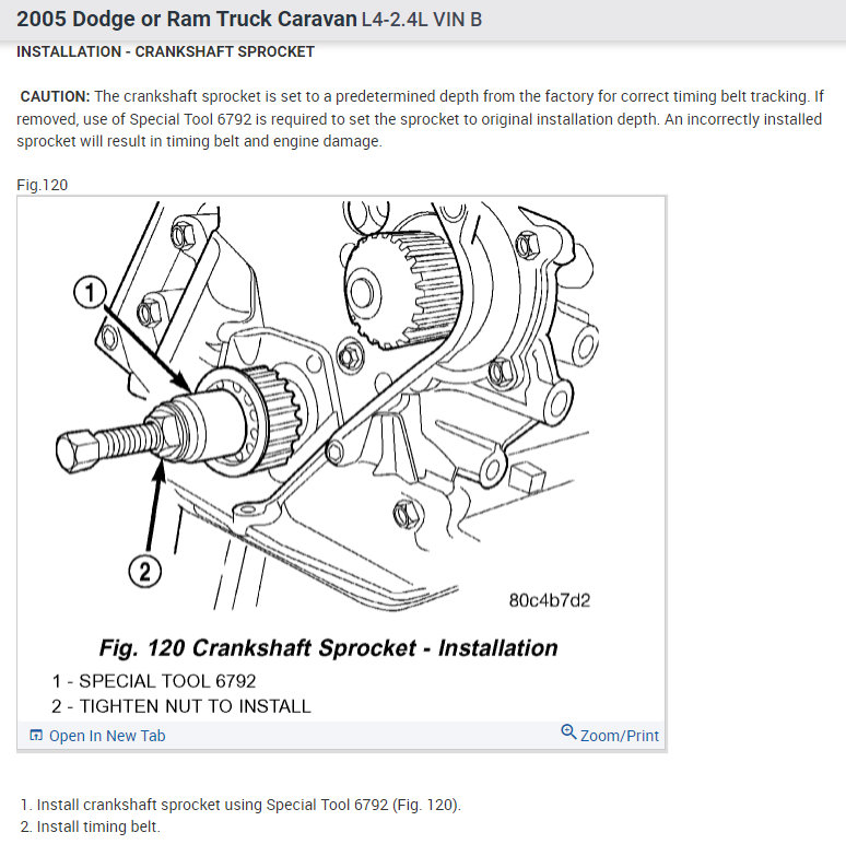

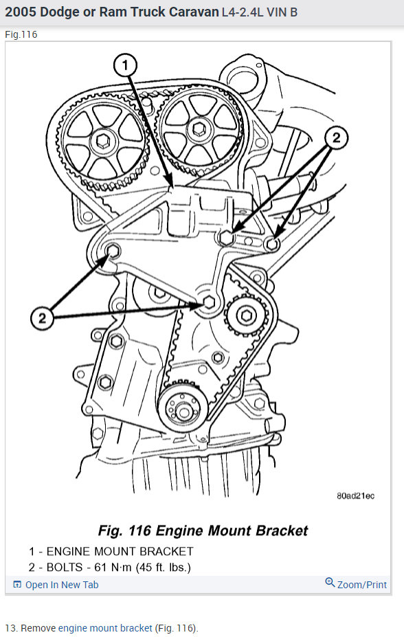

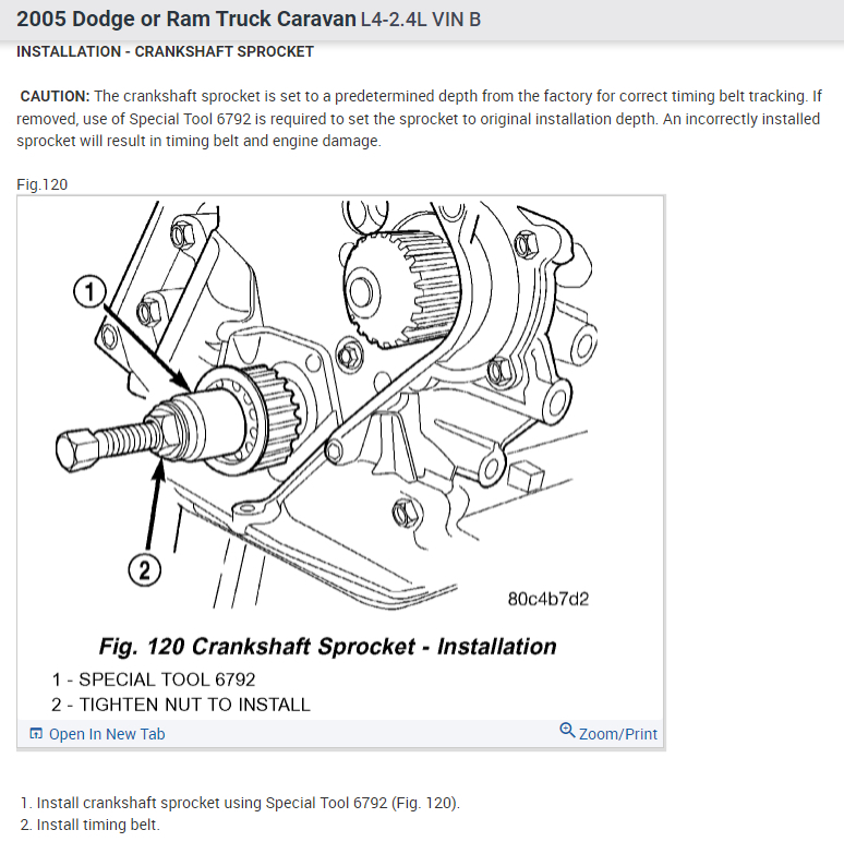

how to set the timing marks on the cam shafts
Jan 1, 2009 at 9:46 PM
SQM
  • 6,383 POSTS

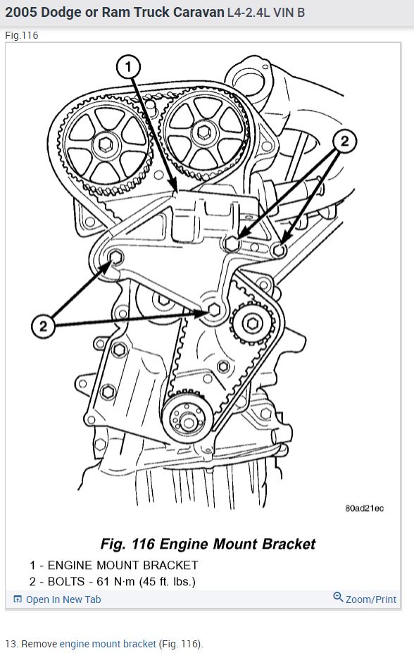

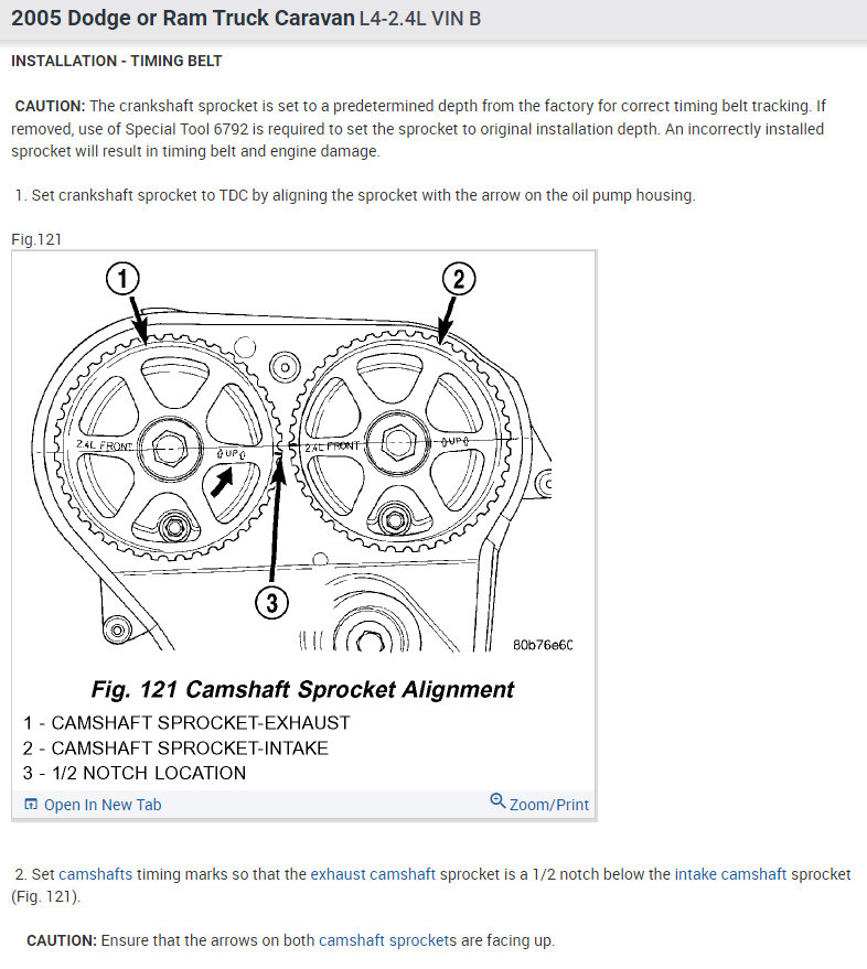

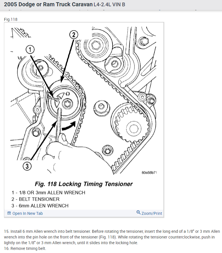

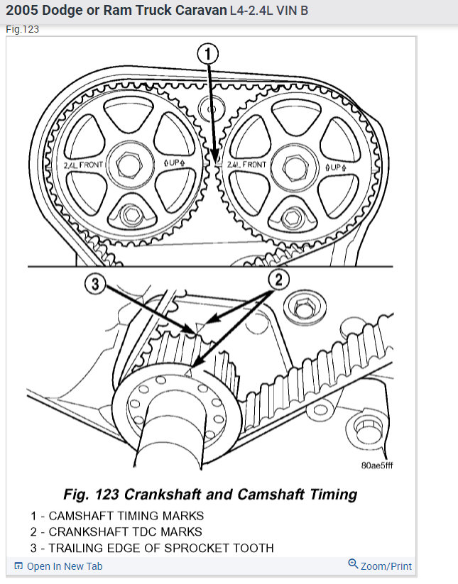

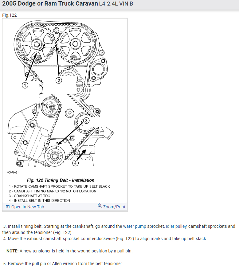

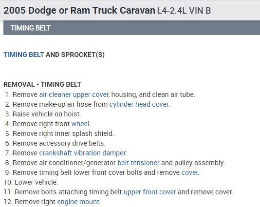

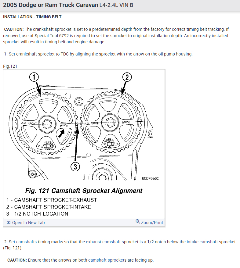

When the timing belt gets replaced it is critical to set the timing correctly by lining up the marks of the cam shafts.
Failure to do so can prevent the engine from starting or can run rough.
https://www.2carpros.com/articles/how-a-timing-belt-works
I have included the diagrams for the timing marks as well as the belt and sprocket replacement procedure.
