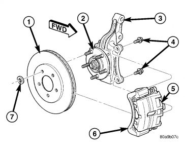

I need to change my front rotors on my 2005 Grand Caravan. Can the spindle nut be re-used? The Autozone website indicates that it needs to be replaced, but you can't buy a replacement from them.

No need to remove spindle nut rotor slids off hub
https://images.2carpros.com/forum/automotive_pictures/198357_Graphic_509.jpg
