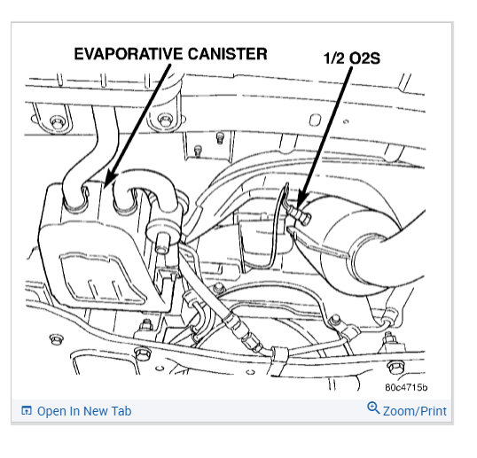

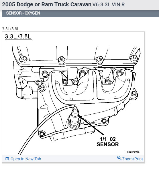

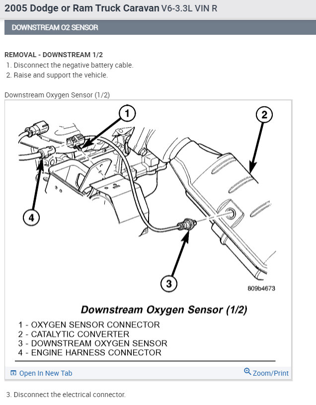

There is no sure for the oxygen sensor heater circuit.
At this stage it will be helpful to know what is the code that you have received on the vehicle.
Many times, the oxygen sensor codes are for a related item but not the actual sensor. Also, if the sensor was the issue, after the replacement and clearing of the code the engine light will be off, there is no "wait period" for this.
The heater circuit code can be due to faulty wiring harness for the oxygen sensor or an issue with the engine computer.
Please let us know the exact code that you have received.
