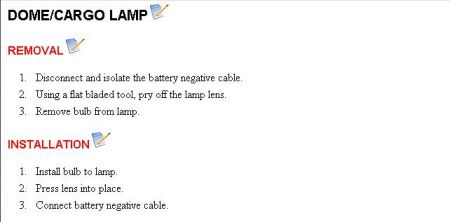

how to change the front dome light in dodge caravan 2005?

https://images.2carpros.com/forum/automotive_pictures/55316_05caravandome_1.jpg
