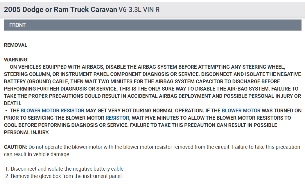

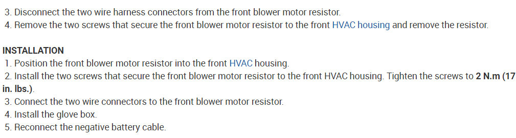

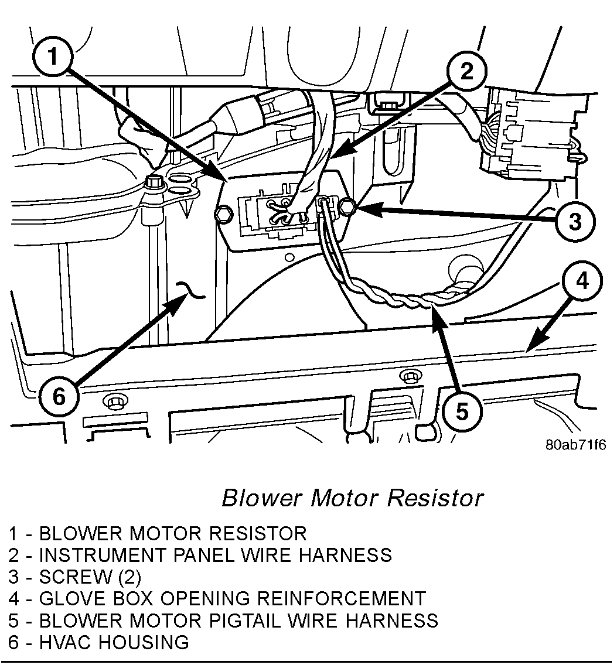

The front blower motor stopped, the fuse is good and I'm told that it's probably the resistor. Can I change the resistor and are there other things I should check?

I've attached pictures replacement steps below for your front blower motor resistor on your van. Hope this helps and thanks for using 2CarPros.
