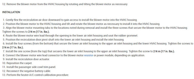

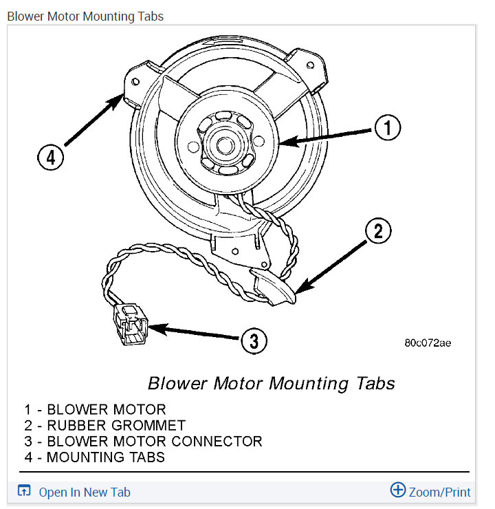

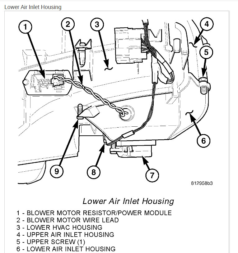

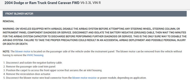

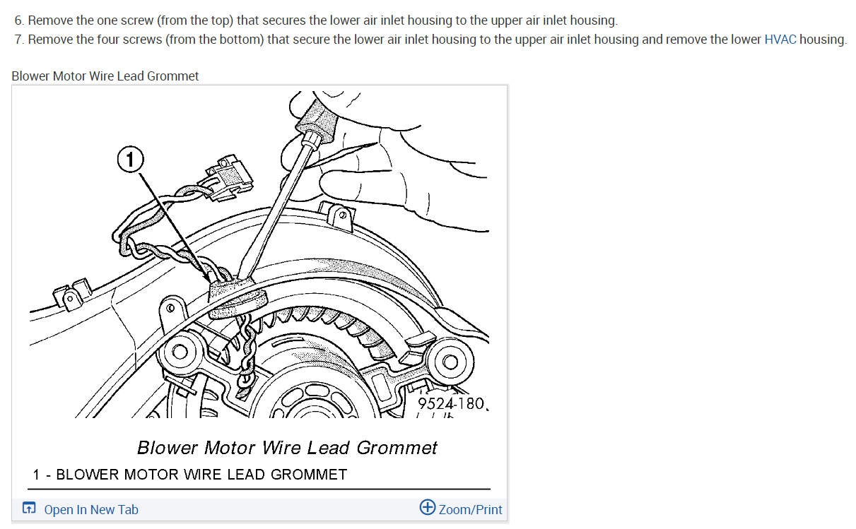

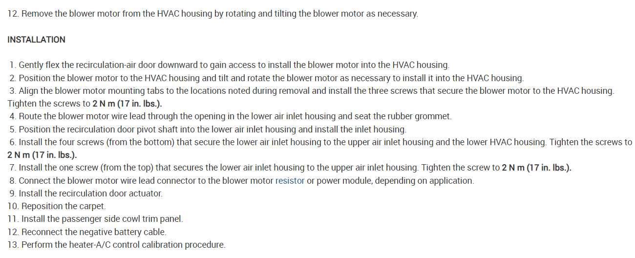

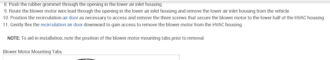

The front blower stopped working (the rear is working fine), where is the front blower motor located?

It should behind or just below the glove box

Here is the location of the blower motor and how to change it out. Check out the images (below). Let us know if you need anything else.
