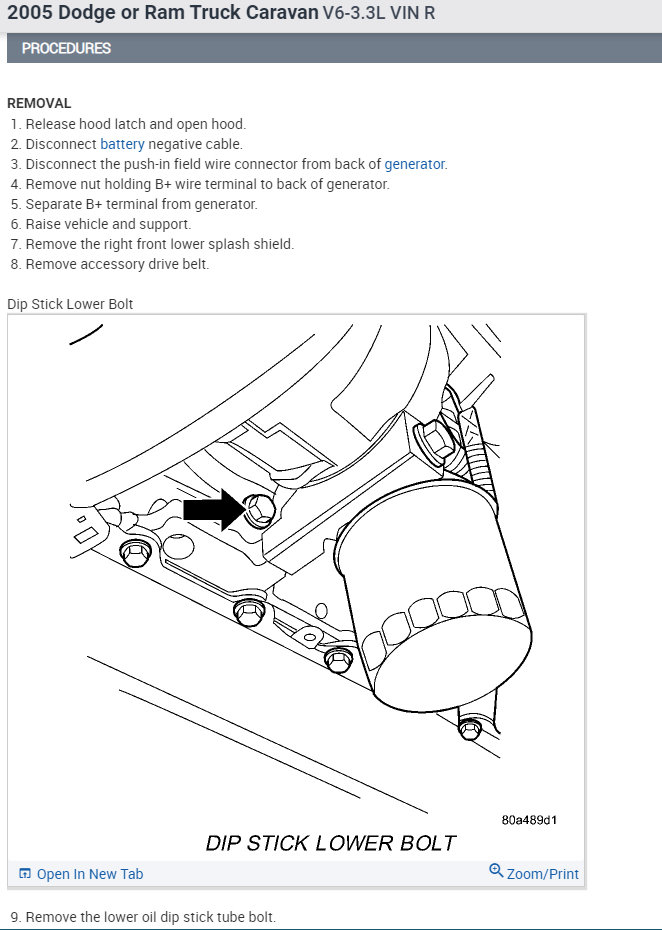

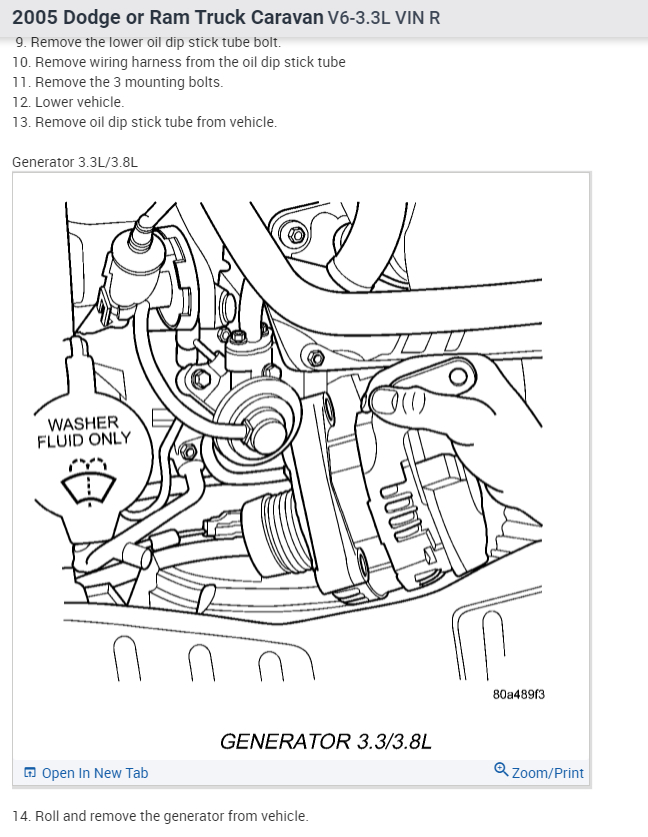

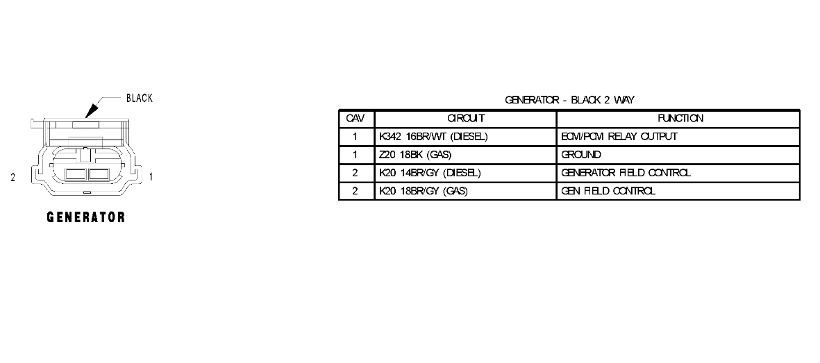

How to remove wires from the Alternator
Dec 4, 2008 at 4:02 AM
SQM
  • 6,383 POSTS

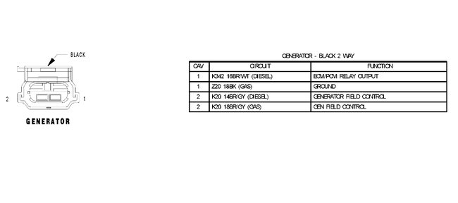

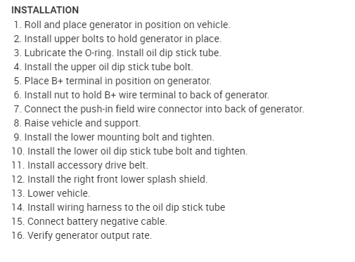

To remove the alternator harness, you will have to push the plastic tab on the connector and pull outwards. Keep in mind it could be little tight due to having a water-resistant seal around the connector.
Here is a helpful guide:
https://www.2carpros.com/articles/how-to-replace-an-alternator
