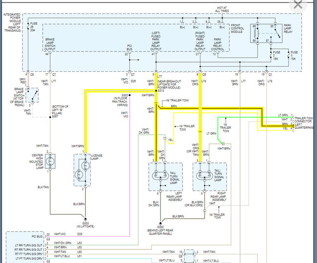

My brake and turning lights wont come up, and I cant find the right fuse for them, to see if I have a blown fuse- it is not in the main fuse box, do you know where are they located?
Sep 15, 2010 at 4:25 PM

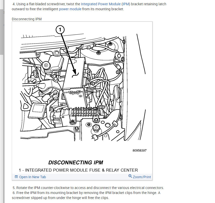

You do not have a fuse directly for these lamps. This vehicle has what is called an integrated power module which is basically a circuit board that controls the lamps.
What I would do is check the voltage at the lamps coming off the circuit board of the IPM and if there is none then you need to replace it.

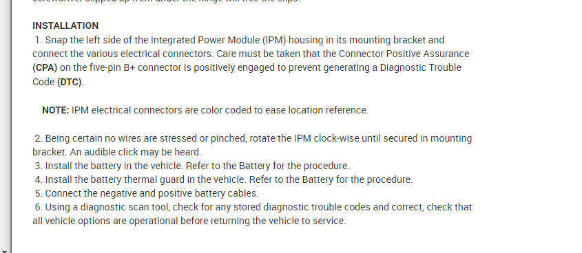

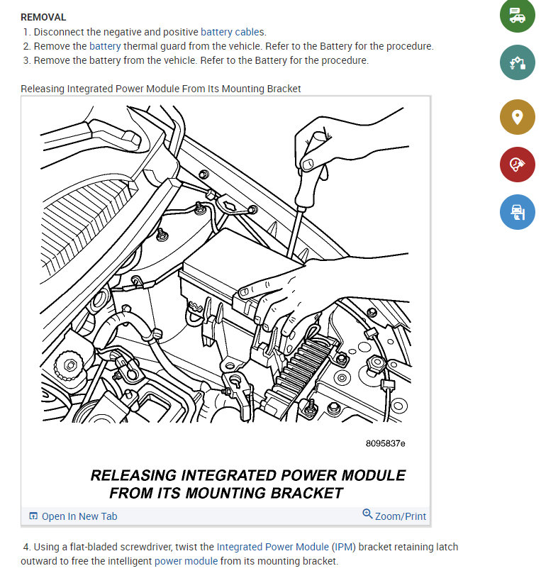

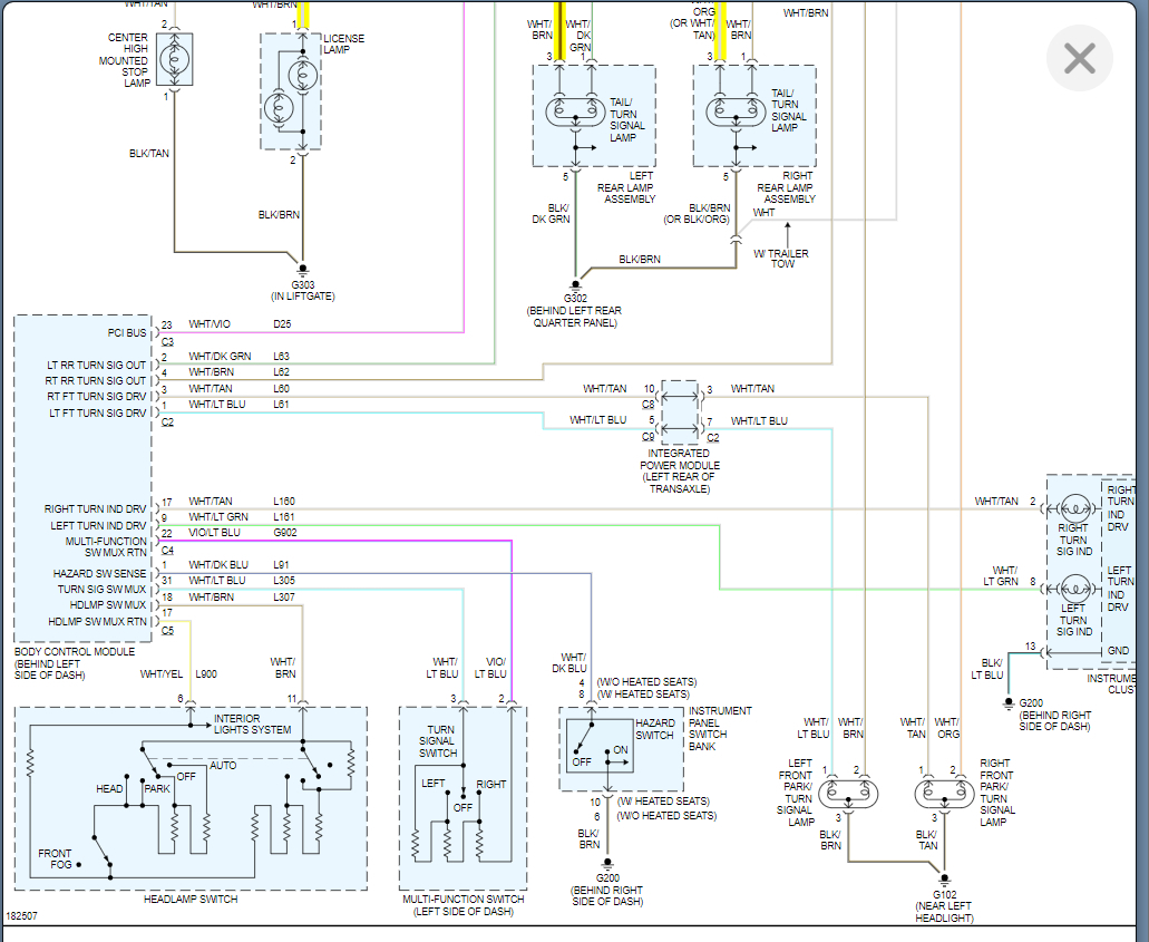

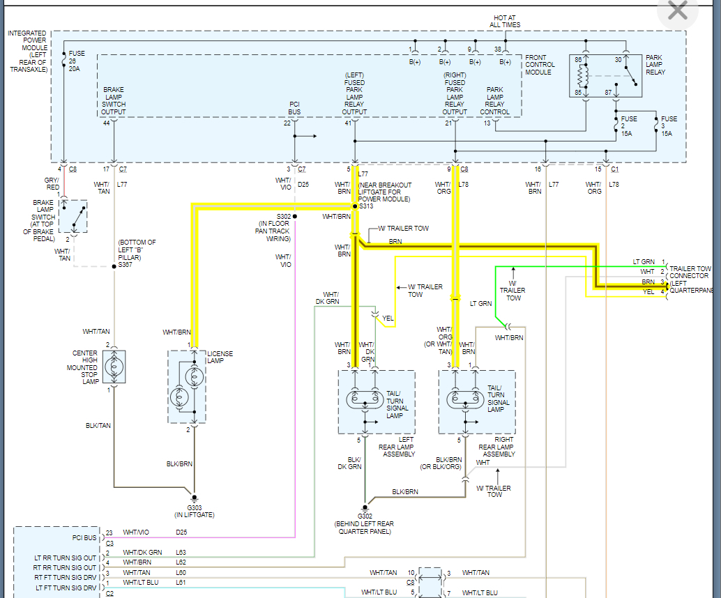

I am attaching the wiring diagram and the process to replace it below.
Please run through this and let us know what you find. Thanks
