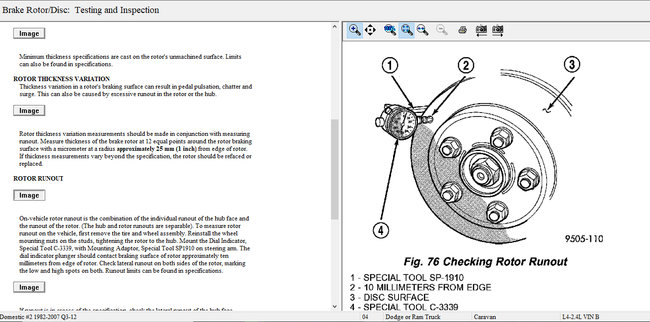

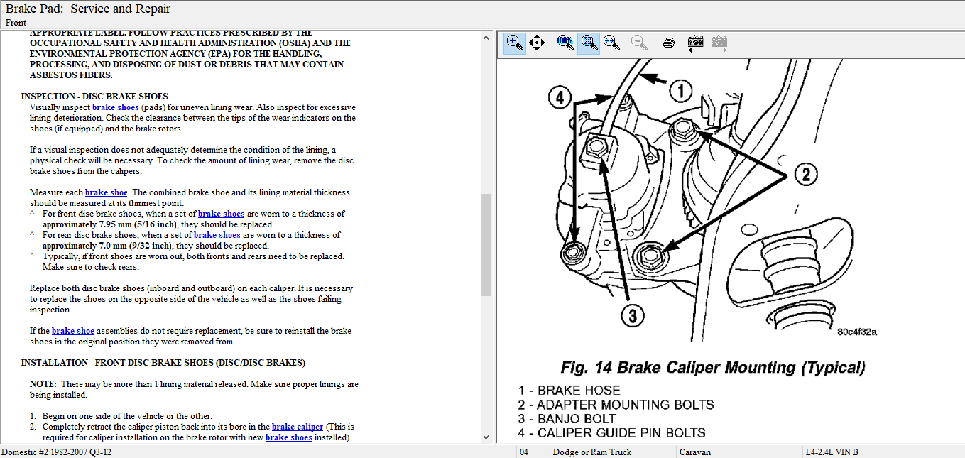

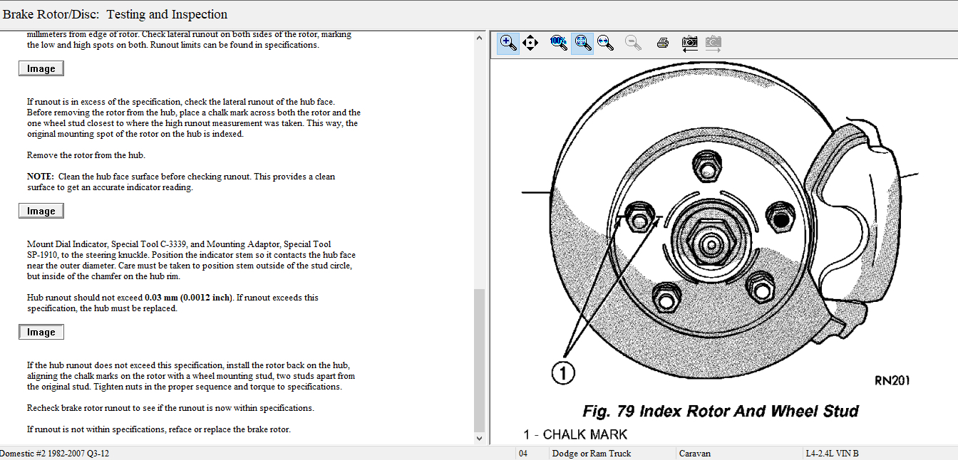

My wife's van almost failed to stop today. She described the problem as the breaks "Shuddering" as she applied the breaks. It only happened once, not recurring as she drove it the rest of the way home (some 15 miles on country roads). I need front brakes
Jul 24, 2009 at 1:40 PM
SEVAG P
  • CAR REPAIR CONTRIBUTOR
  • 405 POSTS

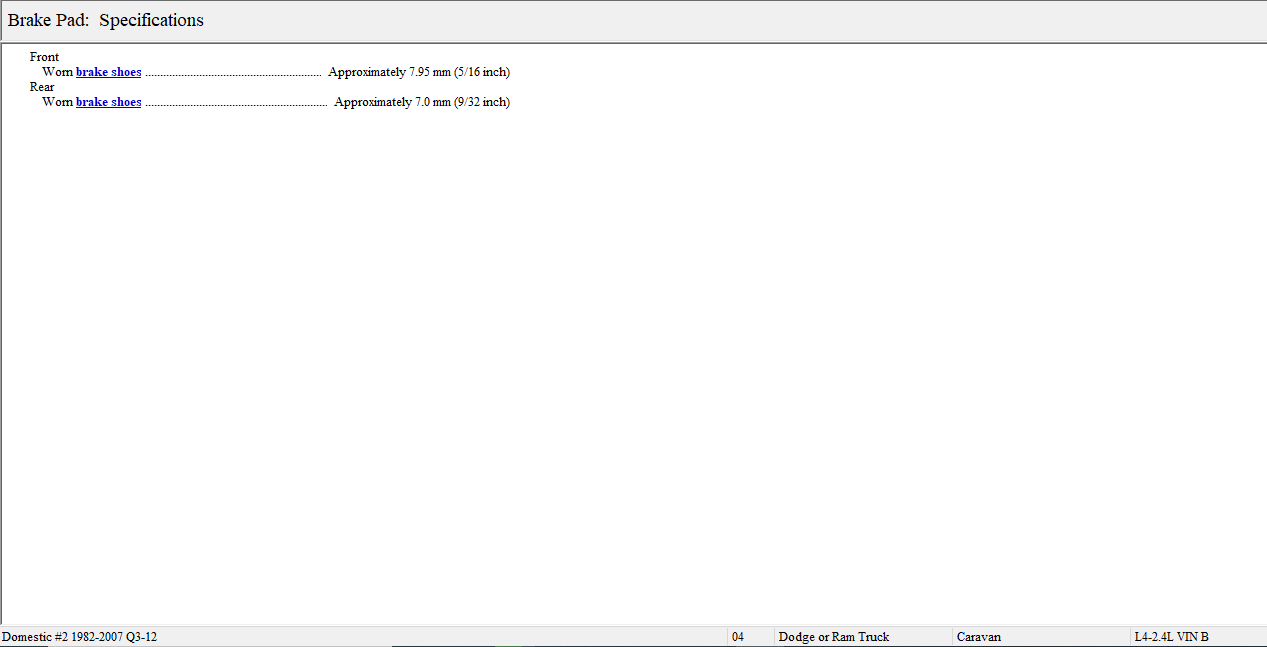

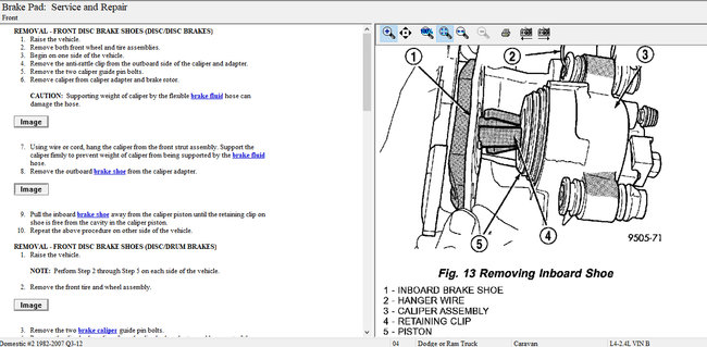

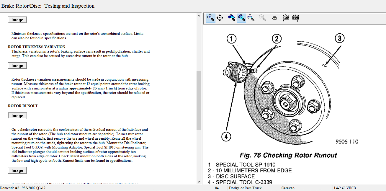

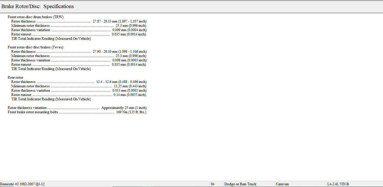

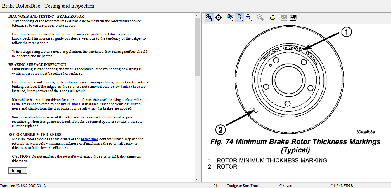

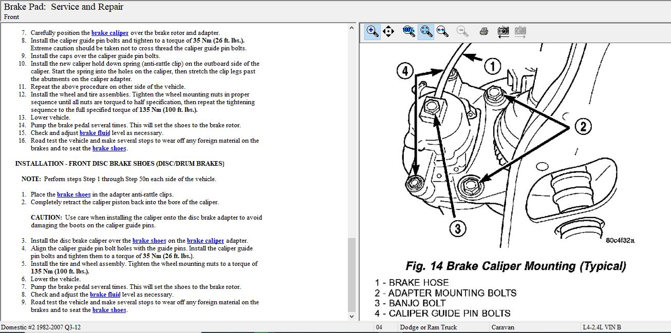

hello.

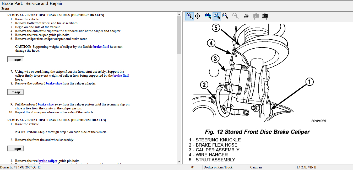

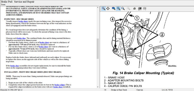

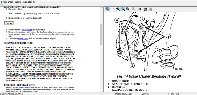

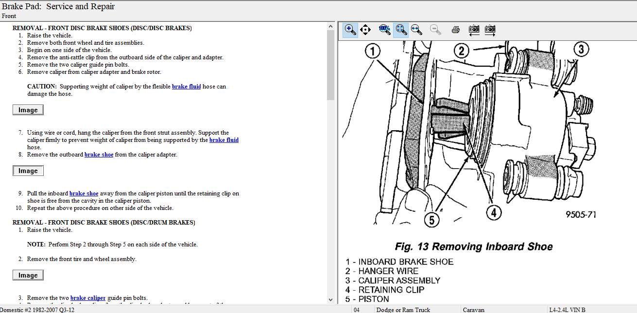

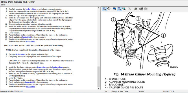

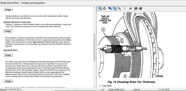

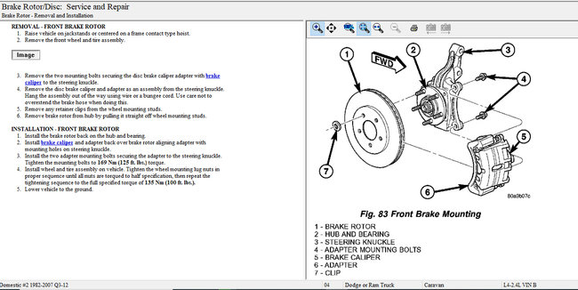

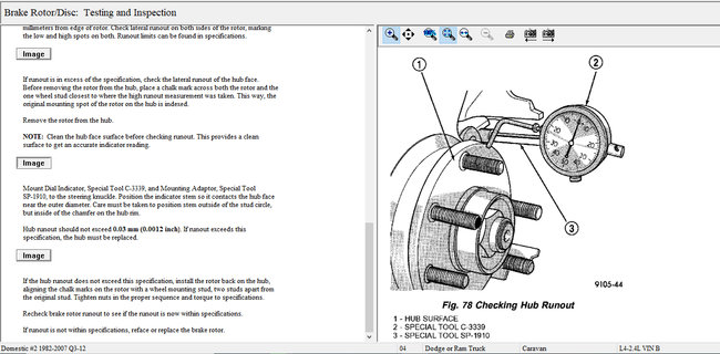

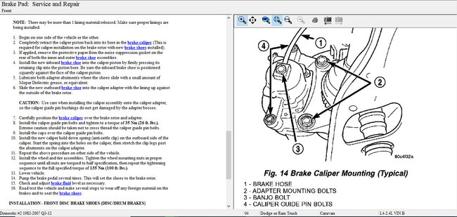

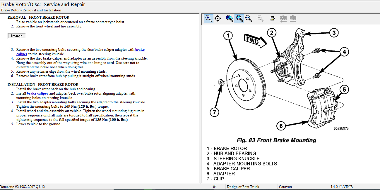

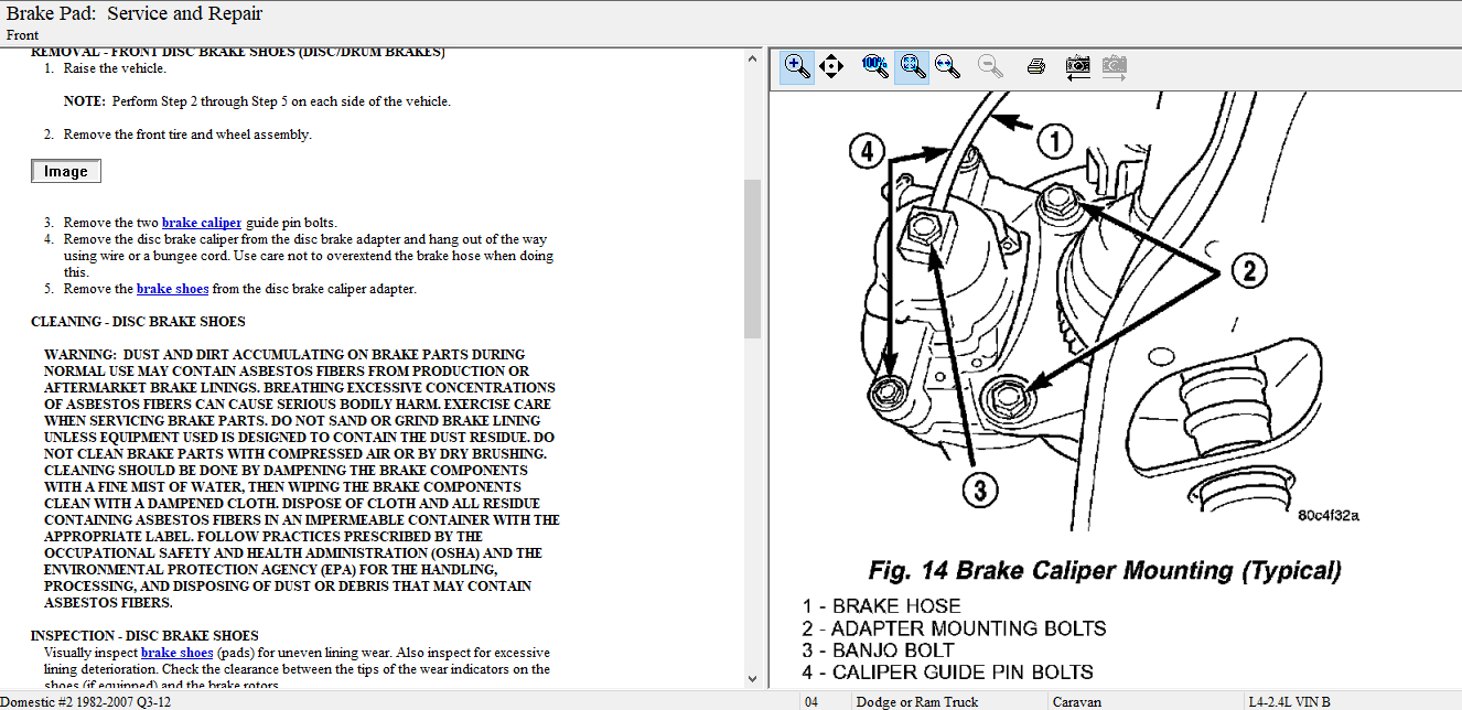

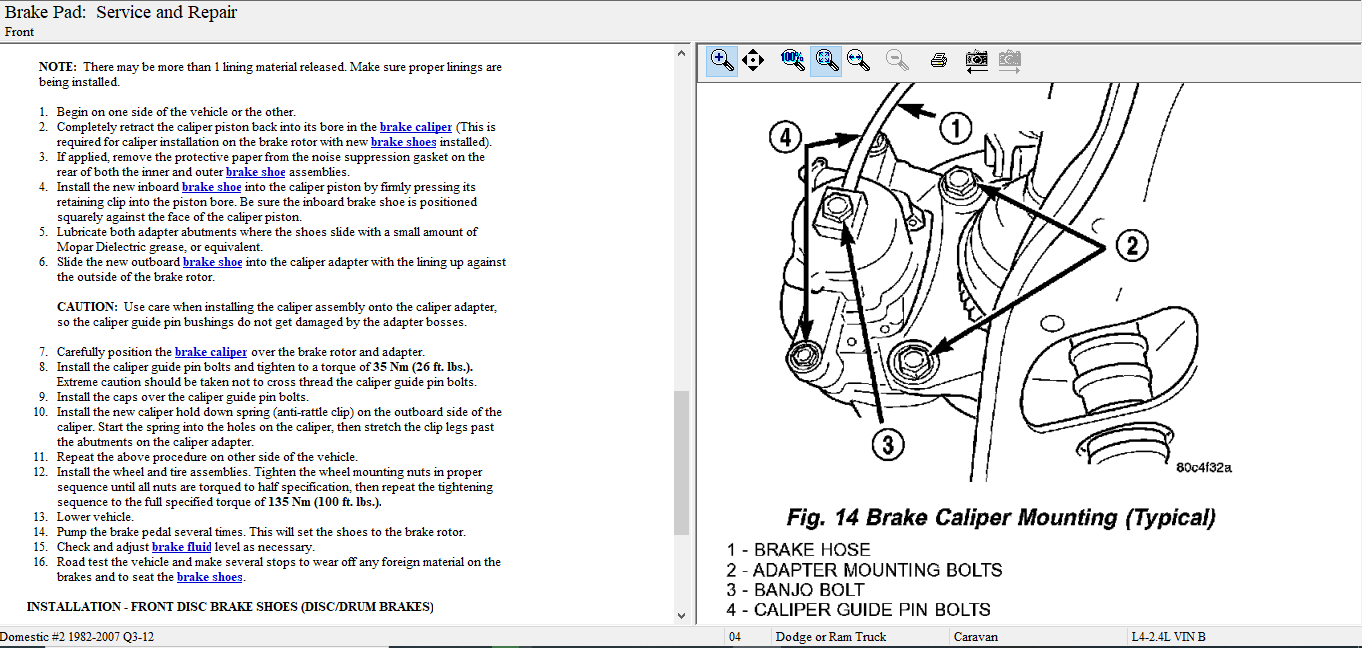

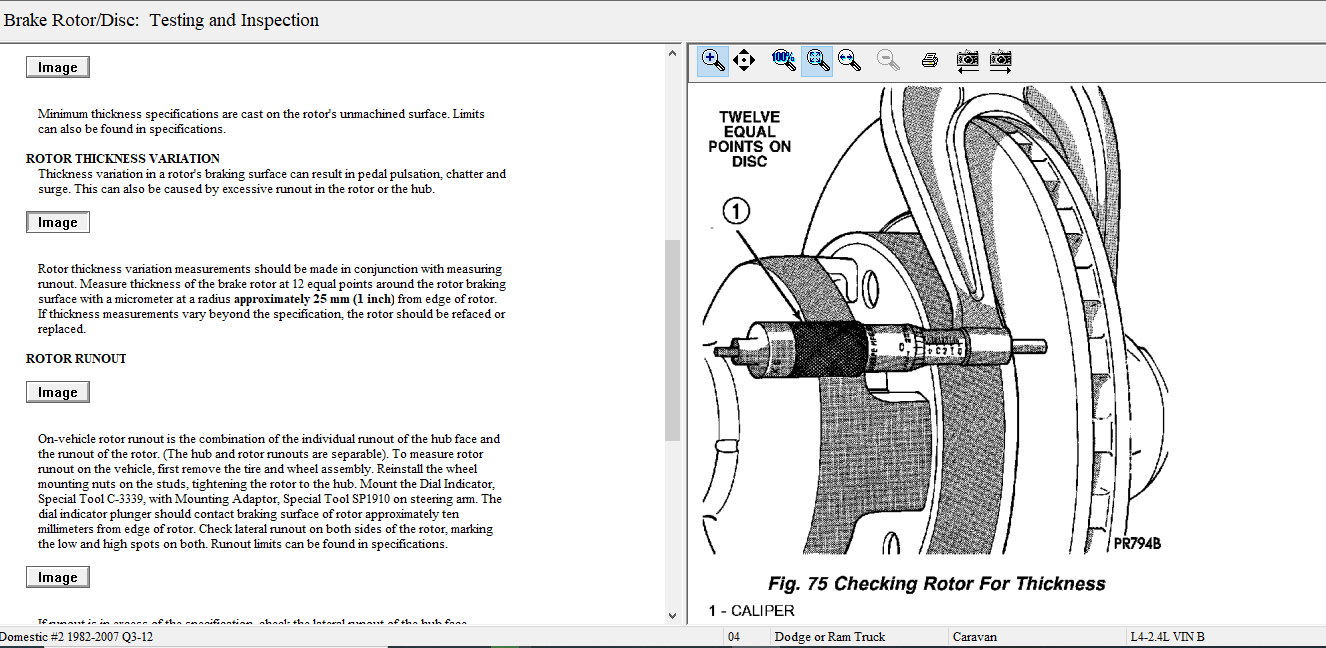

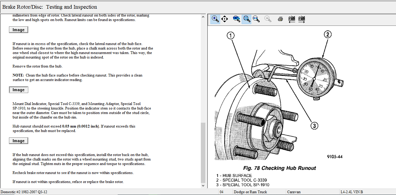

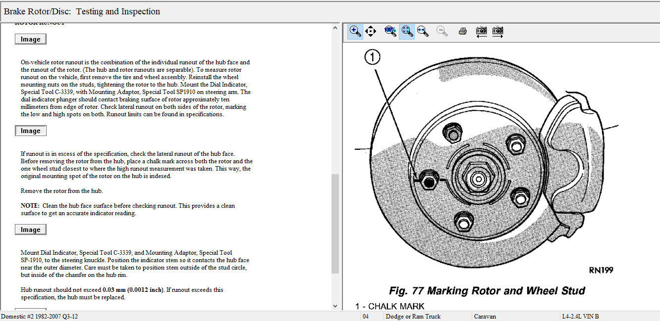

it sound like front brake rotors has excess run out, must be replaced with the front brake pads.
check our guide below how to replace front rotors and pads.
Check the instructions below specific to your vehicle how to replace and inspect front pads and rotors.
let us know if you need more help.
