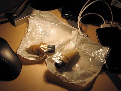

Both sensors came in today (Output Speed Sensor and Turbine Speed Sensor). Have to decide what I'm going to do... am I going to install them myself or ask my good friend to do it for me at his car shop.

Exactly the same situation here. I just came back home from my car mechanic's shop. They replaced it in less than 1/2 hour and charged me $35 CAD. I got both sensors replaced and it really looks a lot better than before. I've noticed it "jumped" but slightly only once on my way back home (some 15 km away). It could also be that engine computer is in learning state now, not sure.
Overall, it looks a lot better than before but it would be really good if we can find out what's the main culprit here.

Little update. Not sure if you're still watching this thread, but I've decided to post this anyway.
For some reason, this problem did not have anything to do with transmission or retraining it for that matter.
I've got another error code 4 days ago, went to my buddy's car shop, got it checked out.
It was P0404.
Replaced my EGR valve same day, and the problem I had with that slight jumping when coming to a full stop went away. Car runs perfectly like I always remember it.
Even though my problem is gone, I'd appreciate if there is someone who understands these things a lot better than I do, so he/she can at least try to explain what this EGR valve has to do with the problem I had and explained in one of my previous posts. How come it's fixed just by replacing EGR valve?
