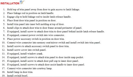

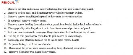

How do I remove the pasenger door panel. Need to

https://images.2carpros.com/forum/automotive_pictures/261618_Noname_2682.jpg
https://images.2carpros.com/forum/automotive_pictures/261618_Noname2_872.jpg
