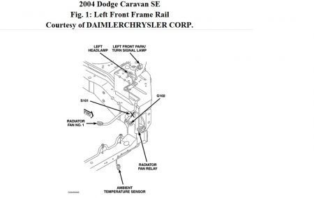

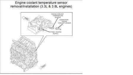

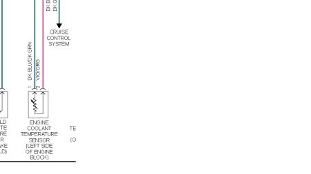

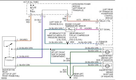

where is the cooling sensor for the fans located on the motor;
Where is the relay for the fans located
Aug 10, 2010 at 3:48 AM
JDL
  • 16,098 POSTS
Found this info in our database. If your not sure which sensor is which, look at the wiring colors. I cannot guarantee the accuracy of database.
