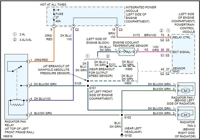

Grand Caravan heat was not working and temperature would go to red then drop.
- I replaced the thermostat.
Heat now works and temperature stays below half way mark. From this it seems water pump is working properly.
However - Radiator is steaming on inside side, radiator is low on fluid.
Twin fans are not coming on.
Seems radiator overflow is directed down edge or front of radiator. I can't follow it under cowl.
-> It seems radiator is not being cooled so, water/anti-freeze is boiling out overflow hose.
I switched windows fuse with Rad Fan fuse. Windows still work but, fans still don't come on.
- Fan fuse must be ok.
How can I test the fans? Do they have in line fuses?
Thank you,
Backyard Bobby
Tuesday, February 2nd, 2010 AT 2:13 PM
  • 75,992 POSTS
Power the fan motors direct from the battery if both works-check and test the following fan relays, coolant temperature sensor or the engine temperature gauge sender/switch and computer. They do not have inline fuses
See the guides below on wiring testing and relay testing, they will help
The wiring diagram for your cooling fans is attached below
