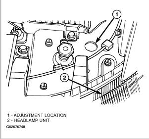

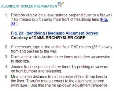

How do you adjust the head lights
Thursday, February 25th, 2010 AT 2:26 PM
JDL
MECHANIC
16,098 POSTS
Hi, I found this info for caravan C/V.
