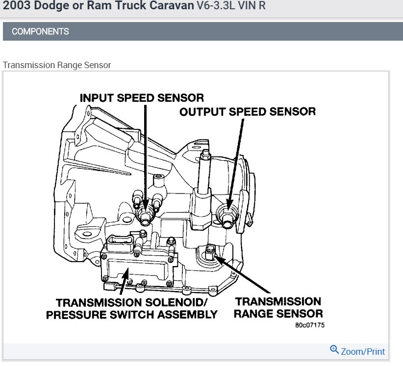

I am trying to find out what might have caused both backup lights to quit working? All other lights are working in the back. (taillights, brakes, turn signals) I looked in the fuse box next to the battery under the hood, even though I could not see a fuse specific to those lights, and none were burned out.

Hi there,
I would check the reverse light switch (range sensor) on the transmission. I will post a picture below. Please use this guide to test through the switch to make sure it is the problem.

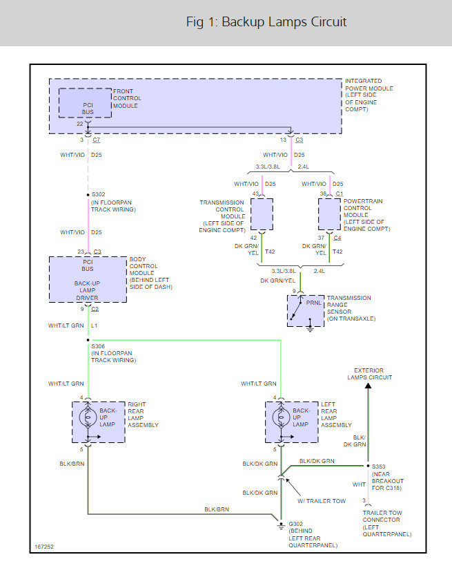

Use this reverse light wiring diagram to help you. Check out the diagrams (Below). Please let us know what happens.

CRIP54
Thanks for the help. I used the guides and you were right the switch/sensor was bad I got a new one for $54.99 and the problem is all fixed. :) I love this site.

DNO36
Two of our vans have had the same issue. The body control module is involved as well. I can reset mine by pulling the "IOD" fuse in the under hood fuse box, waiting about thirty seconds and replacing. You will need to reset your radio stations, but it works.
