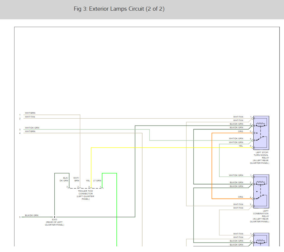

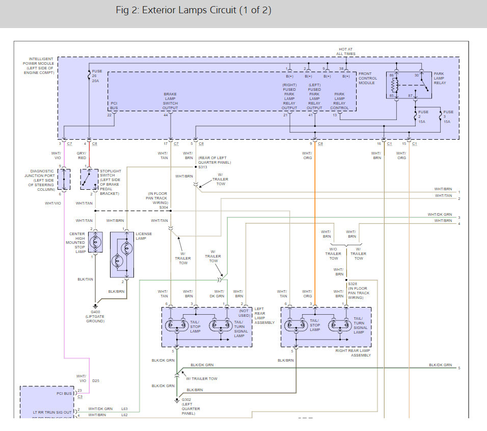

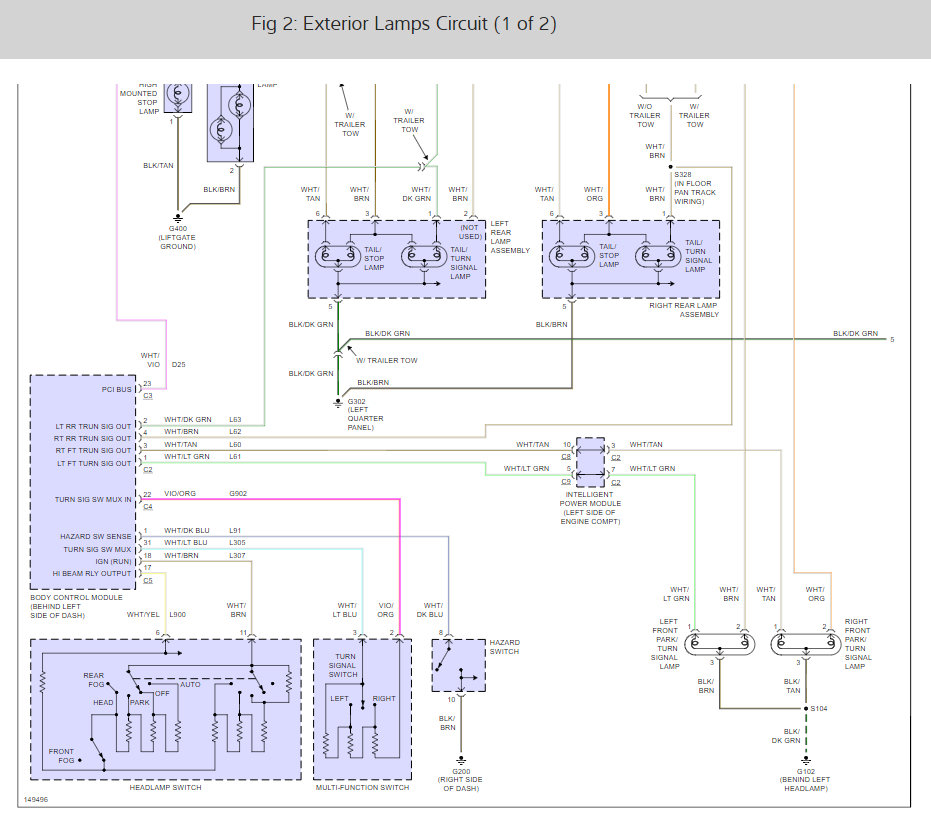

You won't find a flasher like your used to. All the fuses are in the front power center called an intelligent integrated control module, the combination(turn signal switch) only signals the body control module (BCM). It operates the lamps on the dash and it relays the front module, this controls the relays behind the quarter panel trim. Actually it's a little better than 2001. Test the fuses. What is wrong? Are any bulbs out?
Here are the blinker wiring diagrams so you can see how the system works.

Use this guide to test for power inputs and outputs of the TIPM

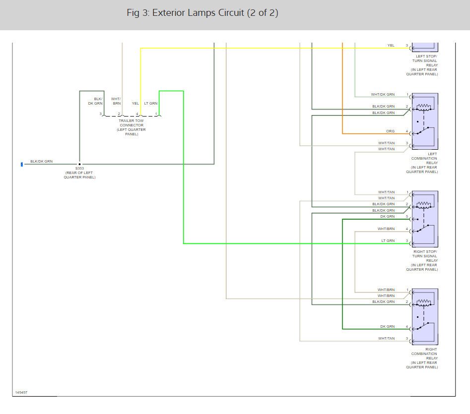

Check the BCM is connector can get burned out bulb from taking a dump.
Any lights on that side out beside the blinkers? If you need the tracer colors for each wire here is another guide I found

Seems like a pain in the butt just to change a stinking turn signal flasher. I'm old school and it used to be a simple matter to change one, so I ended up replacing the TIPM and now everything works ya!
Thanks for your help on this one.
