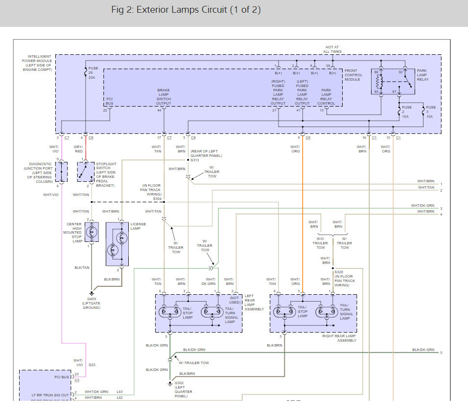

Where is turn signal flasher location on my 2002 Caravan Sport? Are there any photos of what it looks like. They tell me it's under the dash by the steering column, but I cannot locate. -KS

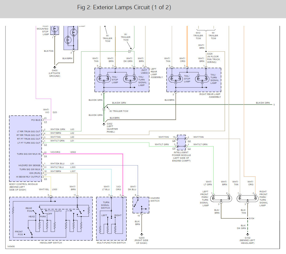

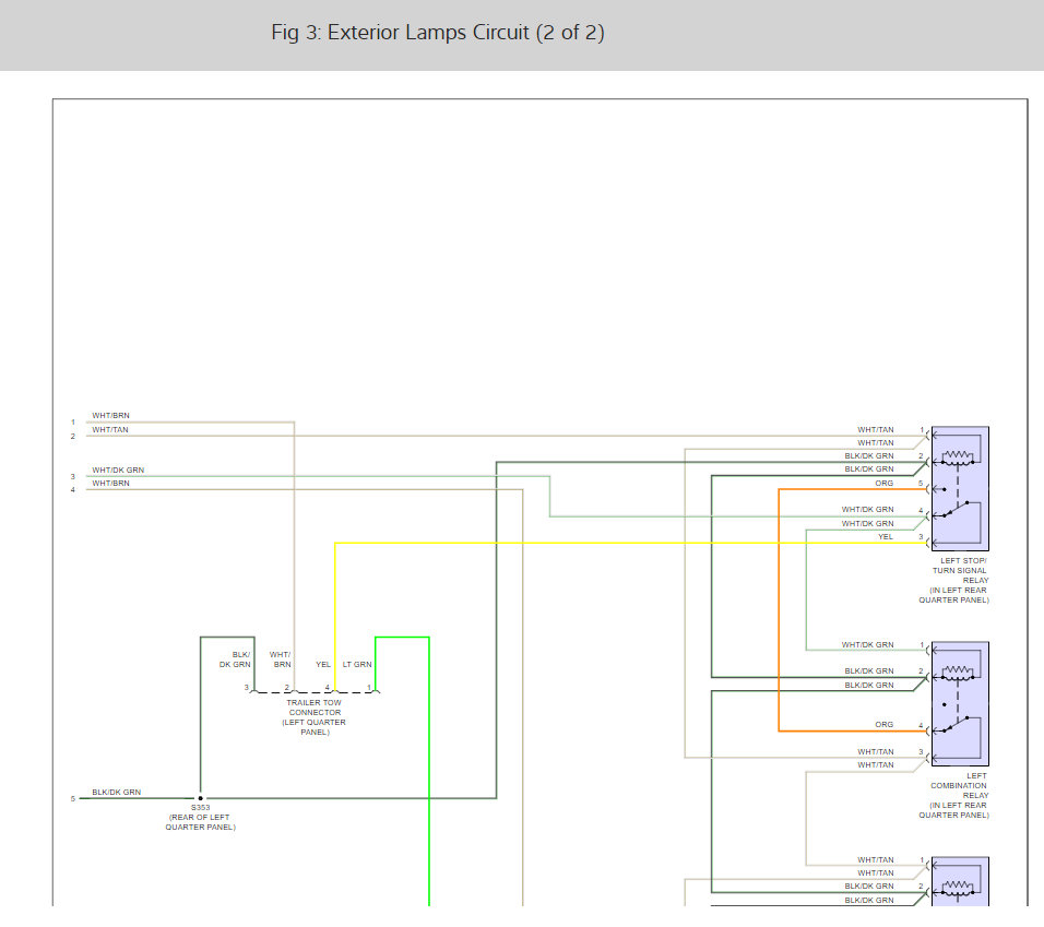

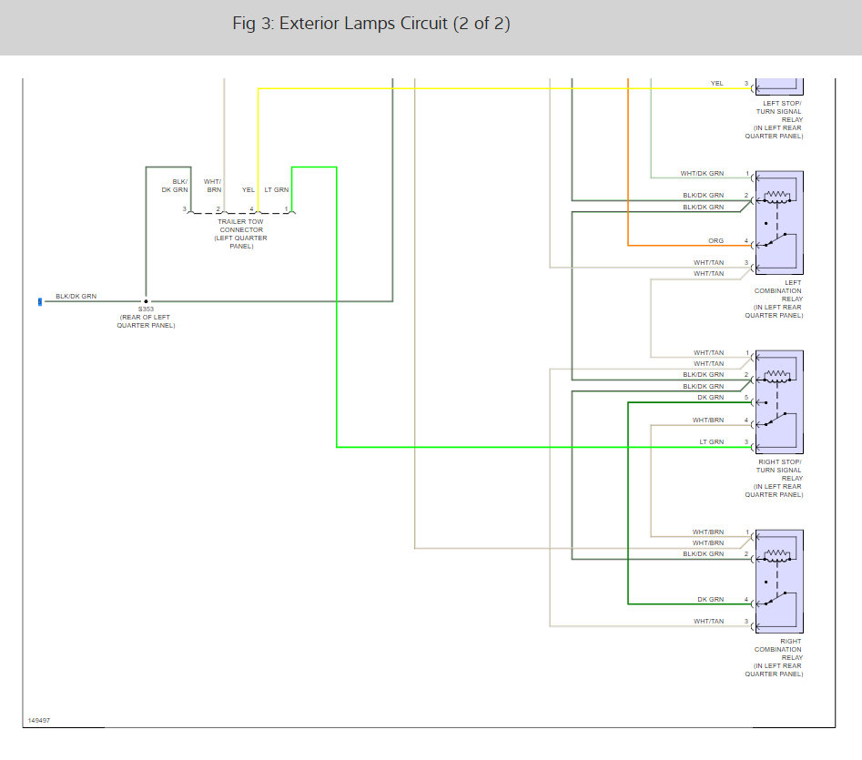

You won't find a flasher like your used to. All the fuses are in the front power center called an intelligent integrated control module, the combination(turn signal switch) only signals the body control module (BCM). It operates the lamps on the dash and it relays the front module, this controls the relays behind the quarter panel trim. Actually it's a little better than 2001. Test the fuses. What is wrong? Are any bulbs out?
Here are the blinker wiring diagrams so you can see how the system works.
Cheers

the blinker are just not working they don't even come on.

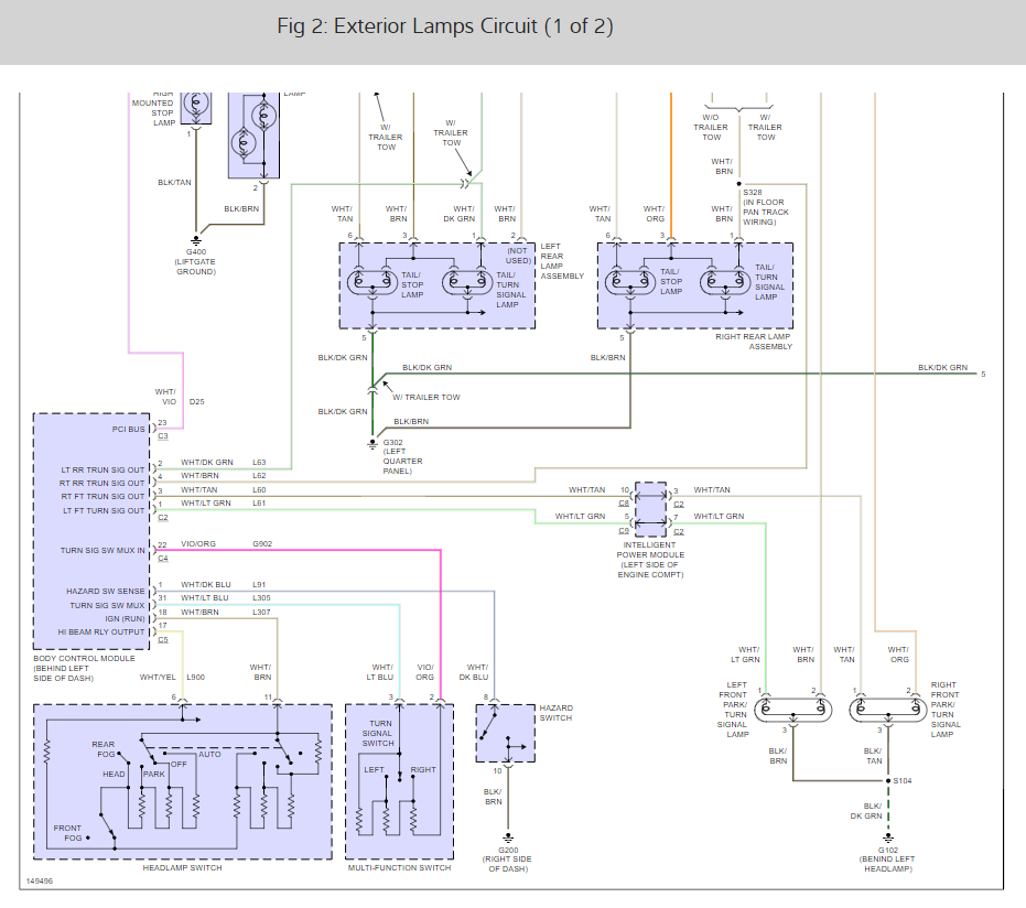

Use this guide to test for power inputs and outputs of the TIPM
Sorry I should have said that in the first post :)

All I have to do is identify the pin on each input I will need to get some time to do that I will report back

Check the BCM is connector can get burned out bulb from taking a dump.
Any lights on that side out beside the blinkers? If you need the tracer colors for each wire here is another guide I found
