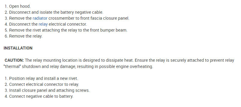

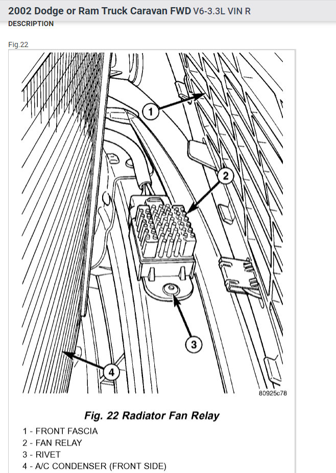

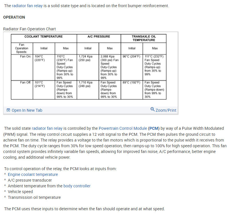

The inoperative fan might be the reason the engine is overheating.
You need to check the relay for the cooling fan.
That relay is located between the front grille and the radiator (see diagram).
https://www.2carpros.com/articles/how-an-electric-cooling-fan-works
You will also need to make sure you are getting power to the relay and the power to the fan connector.
