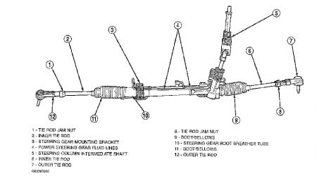

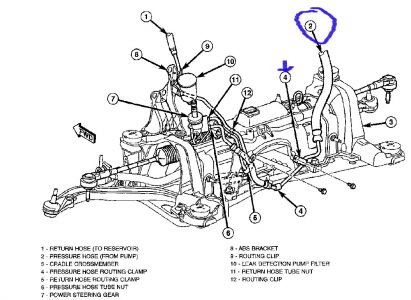

I have a leak for the power steering fluid.
I had crawled underneath and noticed that the line going to the rack and pinion had become disconnected on the passenger side. I rehooked that line and now I have a leak on the driver side but I can't seem to find where that leak is coming from.
Would you recommend that I replace the rack and pinion?

Only if the rack needs replacement...I'm thinking it is a pressure line. SEE #2, might be leaking at the clamp at #4
https://images.2carpros.com/forum/automotive_pictures/30961_rack1_1.jpg
Things that help find leaks are getting areas of concern clean with brake clean or other solvent and wiping it down. Good lighting is a must. There are small mirrors or dental mirrors that also get to hidden areas. A digital camera can also be helpful in areas that are unseen due to lack of accessibility. Lastly, dye can be added to help narrow the source down. The rack has a few lines that are sometimes available and sometimes not. Here is a pic:
https://images.2carpros.com/forum/automotive_pictures/30961_rack_1.jpg
