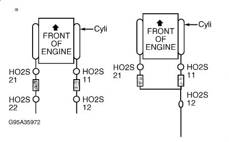

hello where are the o2 sensors located on my vehicle?

Downstream on the catalytic converter upstearm on the exhaust manifold
