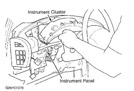

How hard is it to get at these bulbs that light-up your dash gauges, does the whole top of the dash board need to be taken off? Or, can I simply remove the gauge lens plate (without breaking it) and somehow get behind those gauges to replace the burnt-out bulbs?

You will have to take apart the steering column bezel along with a few other components around the gauges, but you will not have to remove the entire dash. You can not get inside of the gauges from the front so removal is necessary for bulb replacement. For detailed instructions on removing and installing the gauge cluster, just let me know if your vehicle is equipped with the electronic transmission range indicator or the manual transmission range indicator (this is the letters D, R, N, P etc. For gear selection).

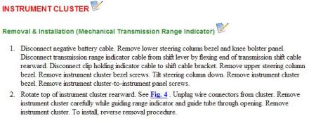

In this van.I have the manual transmission range indicator.

Below are the removal/installation procedures for your vehicle's instrument cluster.
https://www.2carpros.com/forum/automotive_pictures/261618_Noname_88.jpg
FIGURE 4
https://www.2carpros.com/forum/automotive_pictures/261618_fig4_1.jpg
Hope this helps..
Thanks for using 2carpros.com!
