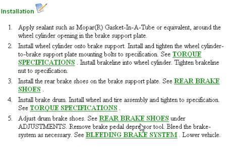

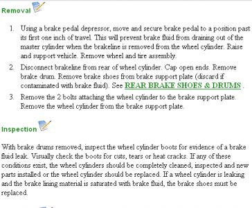

Change rear brake cylinders

Friday, September 26th, 2008 AT 10:36 AM

Friday, September 26th, 2008 AT 10:37 AM
