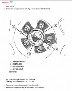

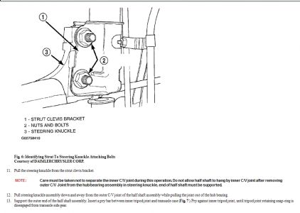

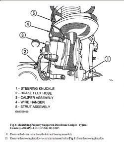

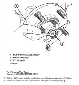

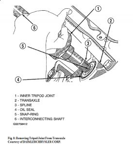

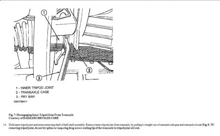

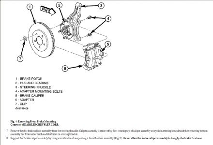

i need to replace the cv axle on my 2002 van on the passenger side are there any special steps that I need to do for this replacement
Monday, April 27th, 2009 AT 7:13 PM
OBXAUTOMEDIC
  • 3,711 POSTS
Here are the Steps to remove. And just reverse to install.... you will also need an Axle Nut Socket you can deptermine the size when you purchase the part the new axle should come with a new axle nut....
