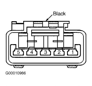

IGNITION SWITCH 1.Remove ignition switch. Check continuity between ignition switch terminals No. 3 and 5 with ignition switch in START and RUN positions. See Fig . If continuity exists, go to next step. If continuity does not exist, replace ignition switch. 2.Check continuity between ignition switch terminals No. 4 and 5 with ignition switch in START position. If continuity exists, go to next step. If continuity does not exist, replace ignition switch. 3.Ignition switch sends multiplexed commands to Body Control Module (BCM). Use scan tool to diagnose affected system(s). For diagnosis and repair, IGNITION SWITCH CIRCUIT FUNCTIONS 1 (Violet/Orange) Ignition Sense Return 2 (Violet/Brown) Ignition Sense 3 (Pink/White) (1) Fused Ignition Switch Output (START/RUN) 4 (Yellow) Ignition Switch Output (START) 5 (Light Blue/Red) Fused Battery Voltage

There are a number of different circuits controlled by the switch so some things might work while others will not. Sometimes problems don't show up until the engine is running because the charging system raises system voltage which results in more current flow through the switch circuits. More current means more heat buildup in the contacts. Engine and road vibration aggravate the problem. Normally I would suggest wiggling the switch when the problem occurs, but since you already replaced it, did you happen to look at the connector? Sometimes a terminal in the connector overheats and becomes discolored or even turns black. In that case, cut the melted plastic plug apart, splice in a good clean piece of wire and solder on a new terminal. (Don't just crimp it to the wire).
