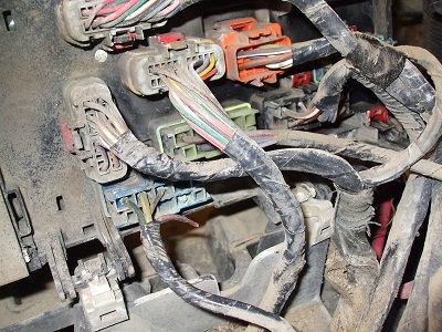

2001 Dodge Caravan All Wheel Drive Automatic 123000 miles
my guages, hazards, and turn signals aren't working although all other lights are working
Wednesday, June 24th, 2009 AT 3:28 PM
WHO905
Same problem. No gauges, turn signals or flashers were working on my 2001 Caravan. Also the chime was fainter than normal. As per many other forums I pulled the instrument cluster but didn't see any problems. Was about to go to the wrecking yard for a BCM. Then I saw another post from a guy named "The Dude"on another forum. I removed the battery and flipped up the IPM fuse box under the hood and low and behold the wire going to the HZD fuse was corroded away. In the picture it is the connector on the bottom left. It is directly beneath the HZD fuse.I removed the corroded terminal added a short piece of wire and a new terminal. Hooked up the battery and all is back to normal !
