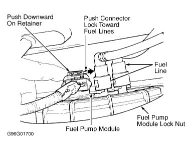

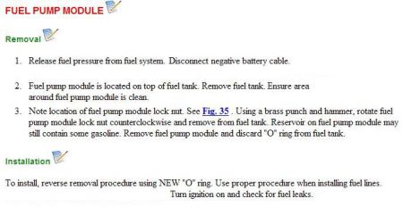

How do I change the Fuel pump on a Dodge caravan 2001. When replacing, do I need to look for any particular type of fuel pump?
Many thanks
May 3, 2009 at 3:04 PM
BLUELIGHTNIN6
  • 16,542 POSTS
I recommend using the dealer's brand pump..other brands tend to burn up much quicker and you will be out more money in the long run that way..
https://images.2carpros.com/forum/automotive_pictures/261618_Noname_505.jpg
https://images.2carpros.com/forum/automotive_pictures/261618_Graphic_25.jpg
