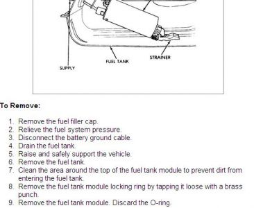

My fuel pump went. I would like to know if it is inside the gas tank and how dificult it is to repair.

Did you check fuel pressure? You can decide if that is something you want to tackle.
