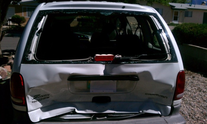

TJWILL
On a caravan that was caused by a hit and run. The gate has a lot of damaged and smashed in and glass is broken. Unable to open gate now
Tail gate has extensive damage. What tools would I need to take off gate.I am not able to open it with a few tugs but will try with several people.
The tail lights still work but where the lincense plate is it is smashed in pretty good from where it was hit from behind. Any suggestions on any latched to release the tail gate or what might help to take off the gate. Thanks
May 4, 2020 at 8:17 AM (Merged)
body work is a different animal. it will have to be cut open since the tailgate is trashed. once you get it opened, the areas around it must be pulled and straightened.
how will you pull it to straighten it?? do you have body tools??
