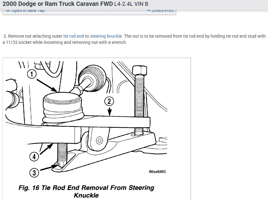

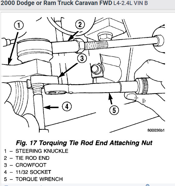

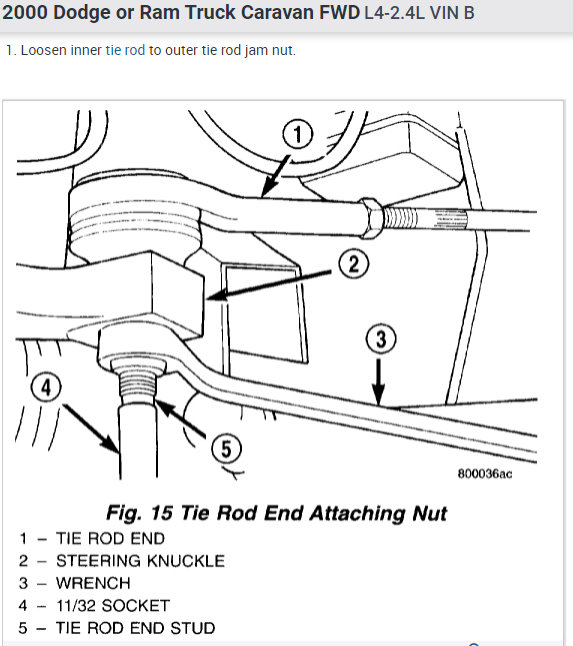

What's the name of the special wench needed to replace the inner tie rods? Do you have a repair process from the manual?
May 2, 2010 at 2:17 PM
SQM
  • 6,383 POSTS

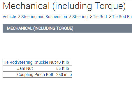

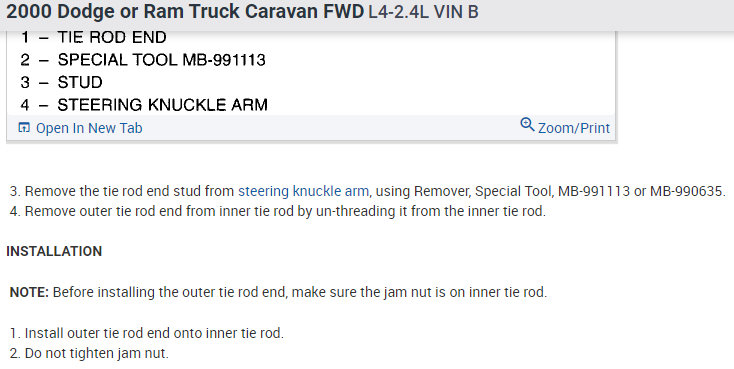

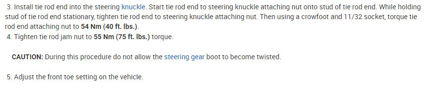

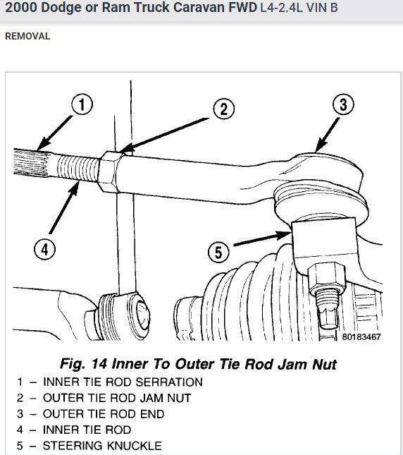

Here is a helpful guide to replace tie rod ends:
https://www.2carpros.com/articles/tie-rod-end-replacement
I have attached the replacement procedure for your vehicle.
Let me know if you have any questions.
