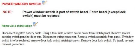

how would i remove the master switch?

https://images.2carpros.com/forum/automotive_pictures/261618_Noname_826.jpg
