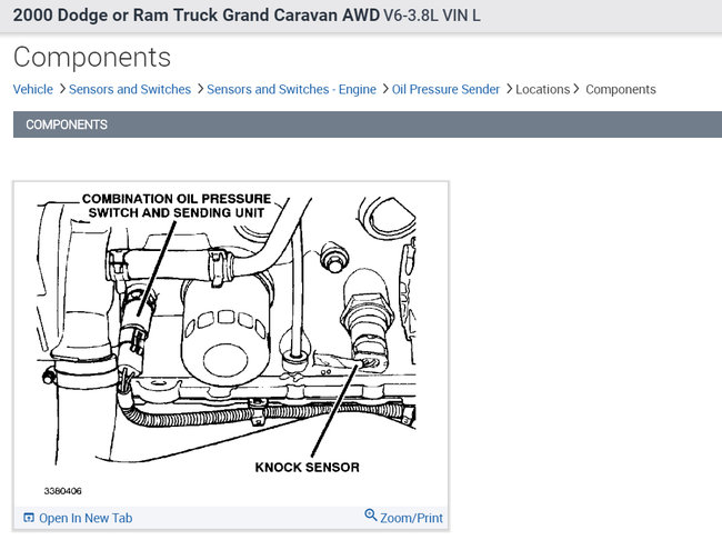

the oil light and chime going off constantly. The oil level is good. before I brought it in to the shop, I thought I would change the oil pressure sensor. Where is this thing located? Do I need to drain the oil before I do it? Do you think this will solve the problem? Should I bring it in and have a professional look at it?
Feb 12, 2009 at 5:17 PM
  • 75,992 POSTS
Here is a diagrams below that shows its location near the oil filter. Check out the diagrams (Below). Please let us know if you need anything else to get the problem fixed.
Feb 13, 2009 at 9:57 AM

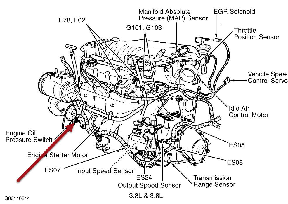

A 3.3L and 3.8L engines its below AC compressor and 3.0 is near the starter

I am trying to locate where the oil pressure sensor is located. I have read the auto manual twice looking for it. I want to replace my current sensor to see if it fixes the periodic oil light that comes on after I have been driving it.

3.0L near the starter.
https://images.2carpros.com/forum/automotive_pictures/55316_98caravan30oil_1.jpg
3.3L/3.8L below the AC compressor
https://images.2carpros.com/forum/automotive_pictures/55316_98caravan33oil_1.jpg

Yes this could be the oil pressure switch infact that is the first thing I would change. You should be able to do it your self. It should be next to the oil filter. This is what it should look like for the 3.3ltr and 3.8 ltr engine.
https://images.2carpros.com/forum/automotive_pictures/249564_275888_1.jpg
