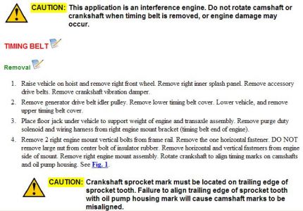

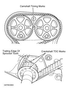

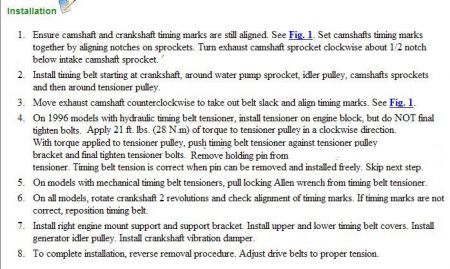

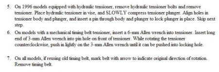

2000 Dodge Caravan how to replace timing chain
KLOSTERLORETTA
Engine Mechanical problem
2000 Dodge Caravan 4 cyl Two Wheel Drive Automatic
I need the specs to replace a timing chain
Aug 25, 2009 at 1:25 PM
BLUELIGHTNIN6
  • 16,542 POSTS
your vehicle is equipped with timing belt not a chain. replacement procedures are below..
https://images.2carpros.com/forum/automotive_pictures/261618_Noname_885.jpg
https://images.2carpros.com/forum/automotive_pictures/261618_Noname2_233.jpg
https://images.2carpros.com/forum/automotive_pictures/261618_Noname3_83.jpg
FIG. 1
https://images.2carpros.com/forum/automotive_pictures/261618_Graphic_132.jpg
