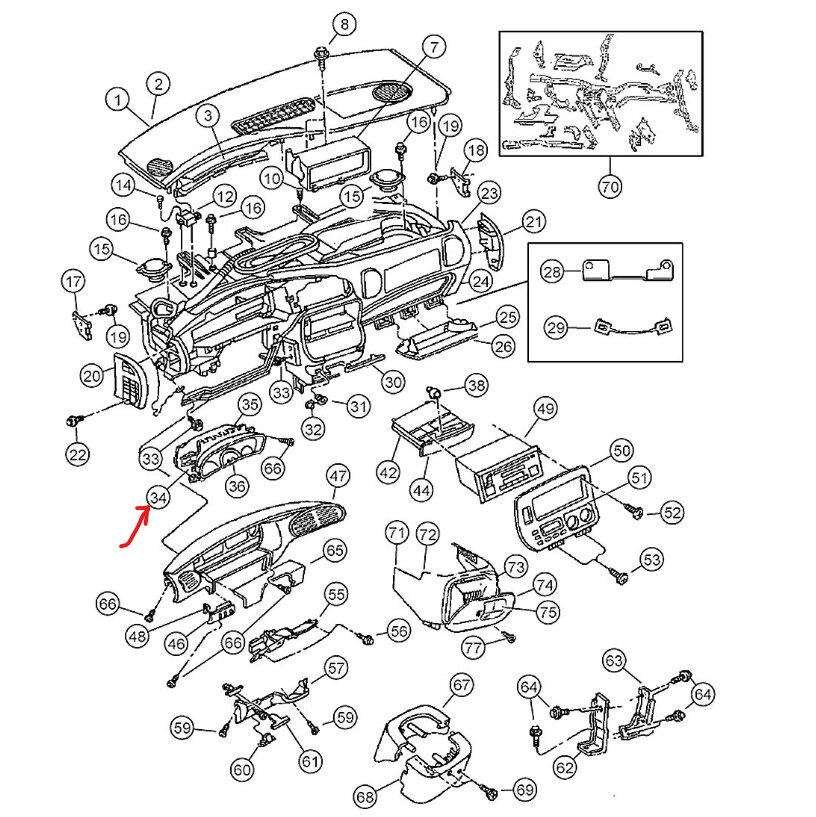

This happens when the cluster is going out, I have seen this problem many times, I would get a used cluster from ebay and install it to help fix the problem. Here is how to replace it.
CLUSTER BEZEL
REMOVAL
1. Disconnect and isolate the battery negative cable.
2. Remove Over Steering Column Bezel by lifting it straight up with a firm pull.
3. Remove the four bezel attaching screws.
4. Tilt the steering column in the full down position.
5. Pull rearward on the cluster bezel and remove.
INSTALLATION
1. Maneuver cluster bezel over steering column and into position.
2. Install the four bezel attaching screws.
3. Install the Over Steering Column Bezel by positioning it over the retaining slots and firmly snapping it into place.
4. Connect the battery negative cable.
Check out the images (below #34). Please let us know what happens.
