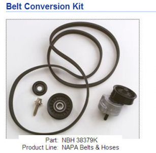

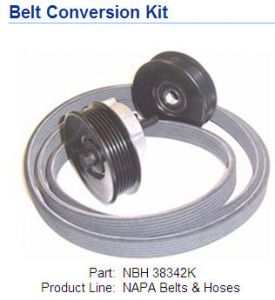

The belt that controls all the pulleys keeps slinging itself off. This is a new belt just put on back in December. This makes the fourth time it has slung the belt off. Other than that it is a decent van
Feb 8, 2010 at 6:53 AM
SERVICE WRITER
  • 9,123 POSTS
There is a conversion kit that will solve it. It has two sided grooved belts and the repair pullies. This is from Napa, but should be available anywhere This is for the 3.0 motor:
https://images.2carpros.com/forum/automotive_pictures/30961_caravan3000beltconv_1.jpg
This one is for the 3.3 Motor:
https://images.2carpros.com/forum/automotive_pictures/30961_caravan3300beltconv_1.jpg
