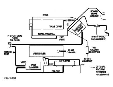

1999 Dodge Caravan vacuum tube placement
1999 DODGE CARAVAN
167,000 MILES • 6 CYL • FWD • AUTOMATIC
BATGIRLT00
My husband is looking for a picture of the engine to show vacuum tube placement. He replaced spark plugs and wires and had to remove the manifold to do so. Can you help with this?
Aug 31, 2010 at 6:07 AM
DOCFIXIT
  • 18,828 POSTS
Hi see diagram next time tell him to mark hoses with masking tape.
