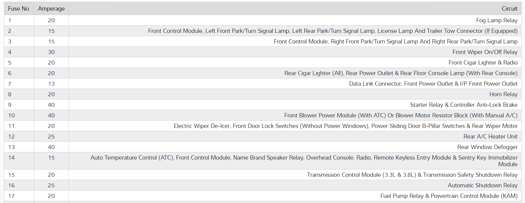

My question emphatically asks which of the fuses in fuse box is the actual fuse controlling the turn signals! Answer is not in manual. I am not asking location of fuse box!

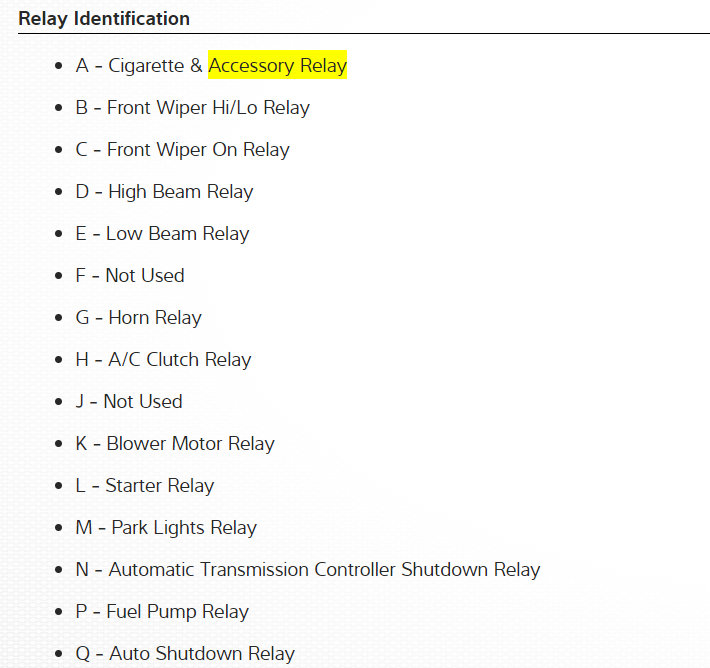

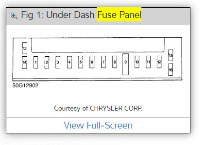

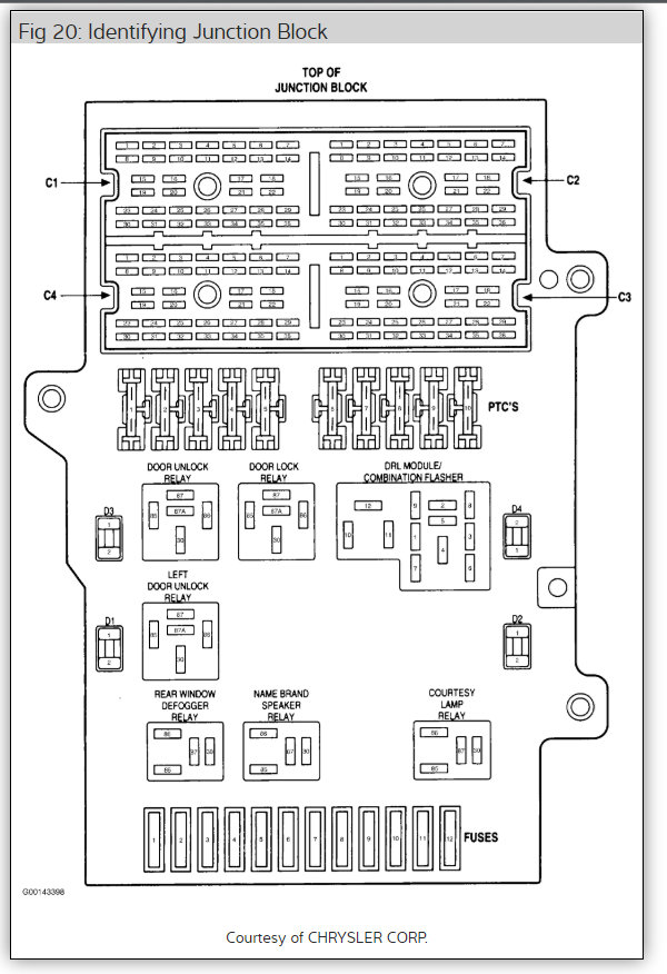

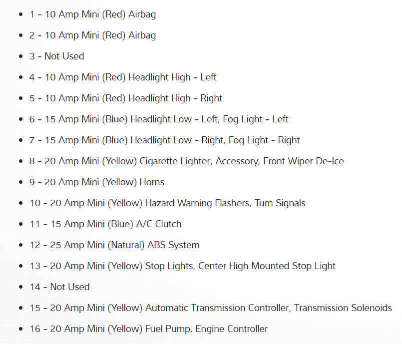

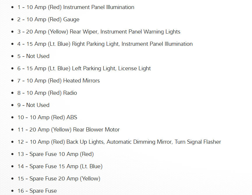

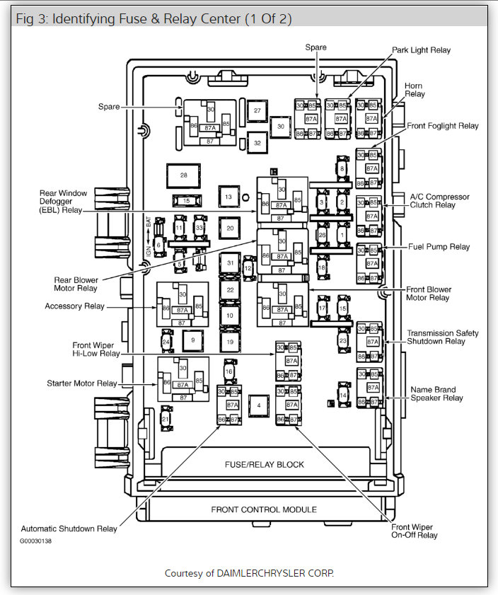

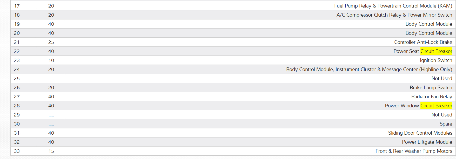

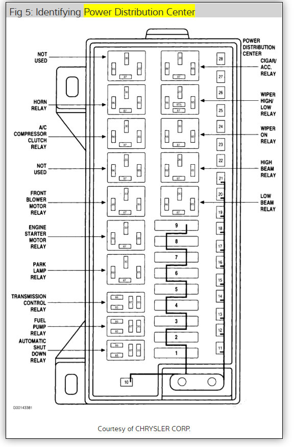

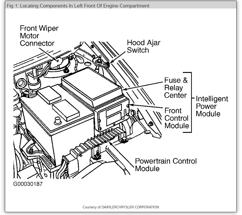

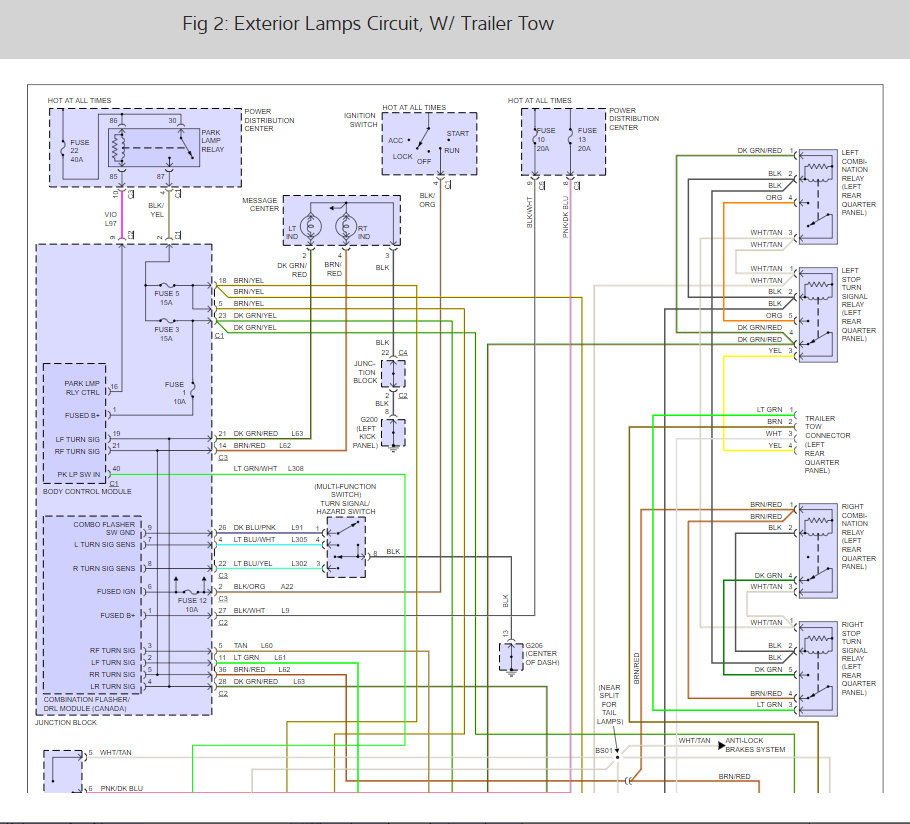

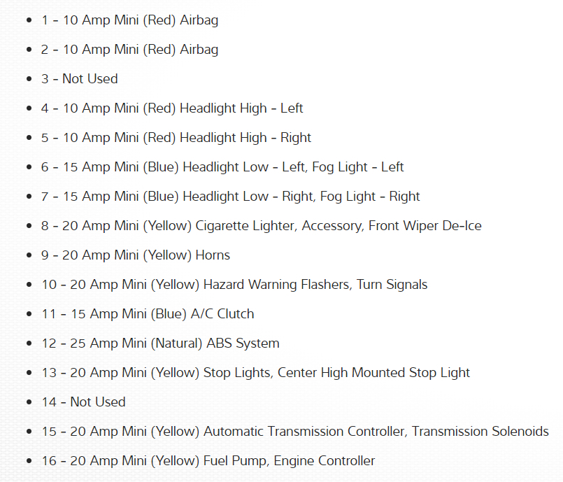

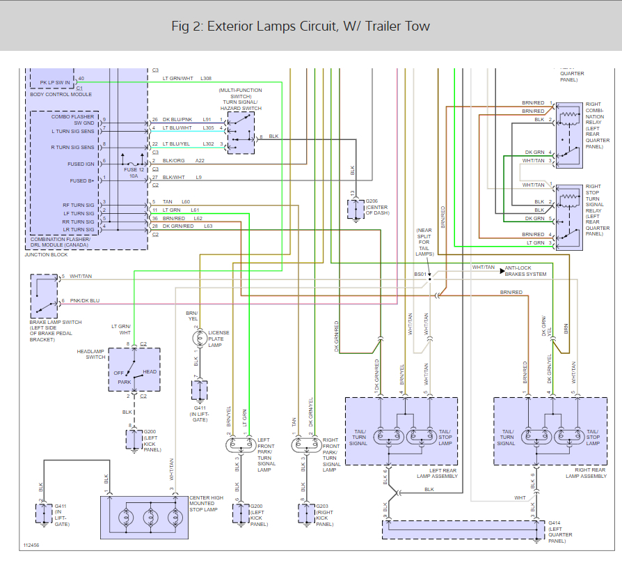

The fuses that run the system are #5, 3, 10 and 13. Here is a guide to help you see how to test the fuse and the wiring diagrams so you can see how the system works along with the fuse locations below:

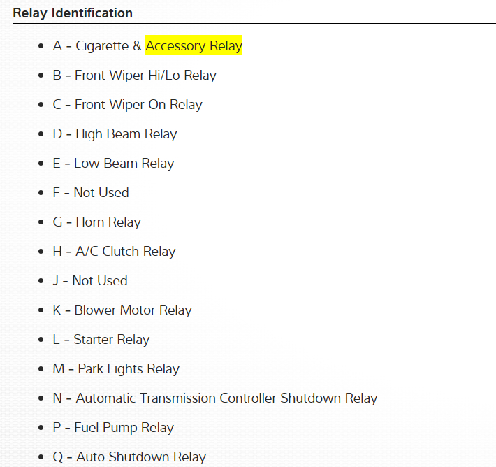

The turn signals are not working on my van. I believe the problem is a blown fuse, but cannot find in the manual which fuse would be the right one to replace or whether it is a relay or something else. Can you advise which fuse/relay to replace and the right amperage for it? Location of where/which fuse In fuse box controlling turn signals is located. No information in manual. Thank you very much.

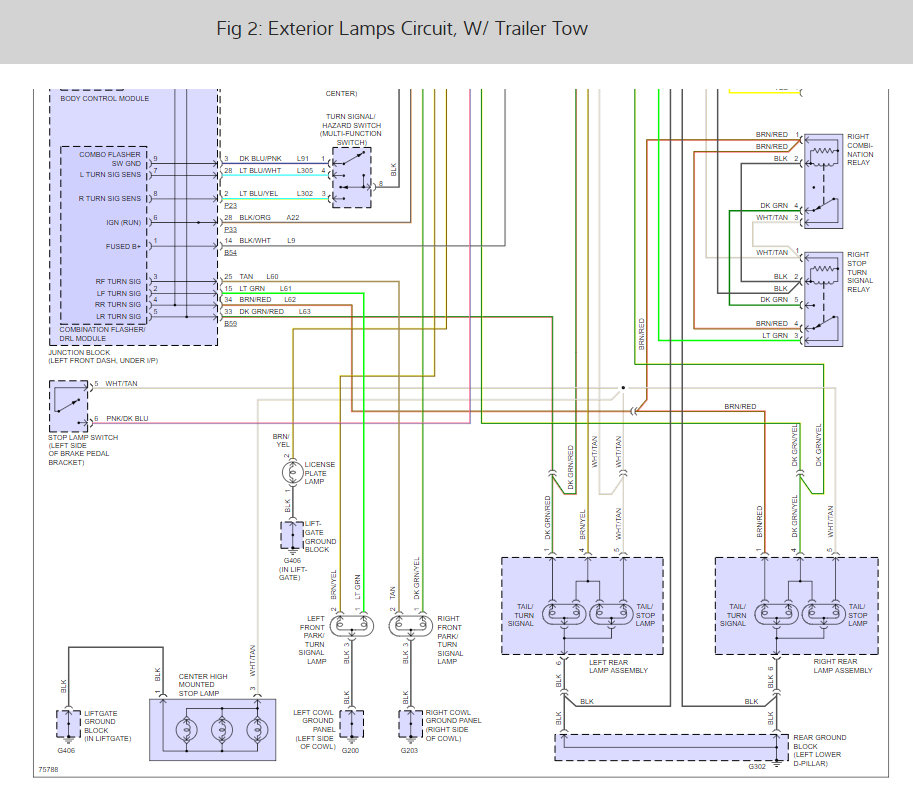

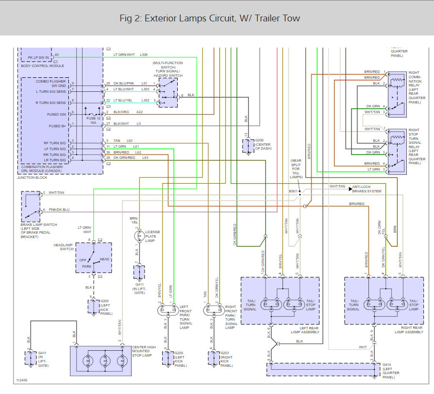

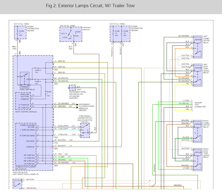

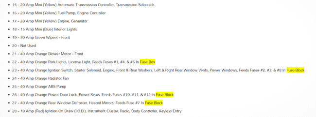

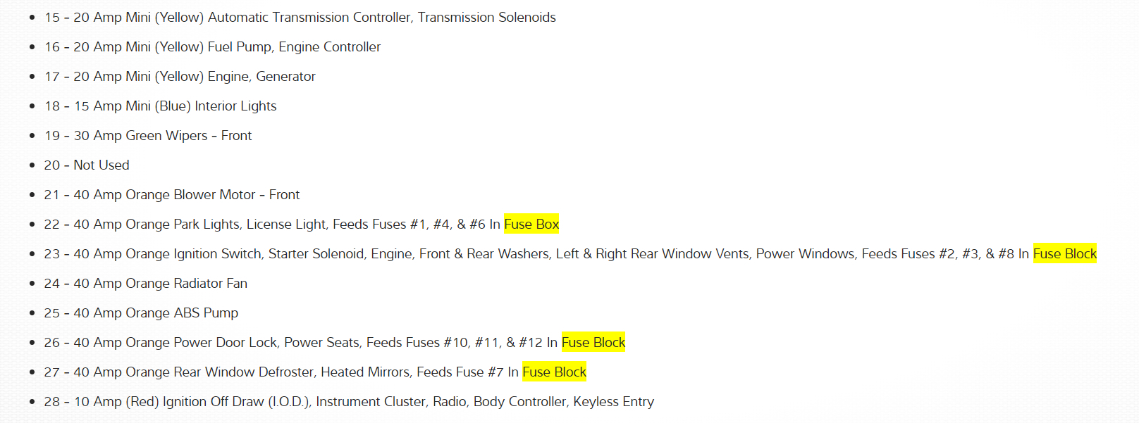

There are four fuses that run the system #15 16,4 and 5. Here is a wiring diagram of the blinkers so you can see how the system works and a guide to help you check them with the location of the fuses:

At the moment, I've got two, probably related, issues on the 1996 Grand Caravan. First, when I turn on the left signal, both the left and right signals go on. (When I turn on the right turn signal, only the right one goes on; this is only a left signal problem.)
Second, the "ding" that is supposed to happen if you leave your turn signal on too long now happens if you leave the headlights on for more than a few minutes. If you turn the headlights off, the ding stops--but then resumes a few minutes after you turn them on again.
We've tried changing all the bulbs, and the fuses, and it's not helping.

check all grounds for the left side lights first.
Oct 29, 2019 at 5:05 PM (Merged)
CVCALHOUN
Any thoughts on how we'd do that? Is there a wiring diagram somewhere that would tell us where the grounds should be?
