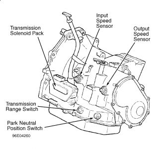

Hello, I just want to know what do you think my problem is with my Car. My car won't shift to the next gear you can actually hear it grinding or wanting to shift but won't when I turn my car on and go then it'll go to the first gear but that's all it'll do. It still reverses but won't shift and if I'm at a stop light it still in gear it's not downshifting I believe that onl once it shifted t 2nd but that's all. Please help...

Need to check for codes suspect speed sensors or tranny solenoids
