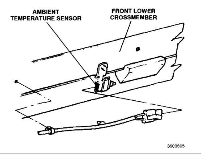

My outdoor temperature module appears to be failing because the reading is not even close to right. Is there a fuse or something that controls that?

It sounds like the thermometer temperature sensor has gone out. I would replace it first. Here is its location (below)
Image (Click to enlarge)
