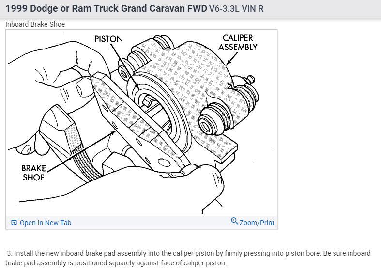

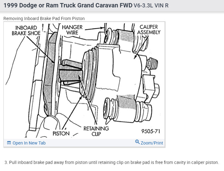

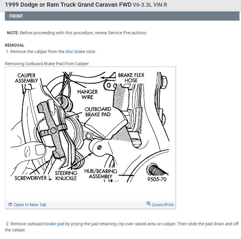

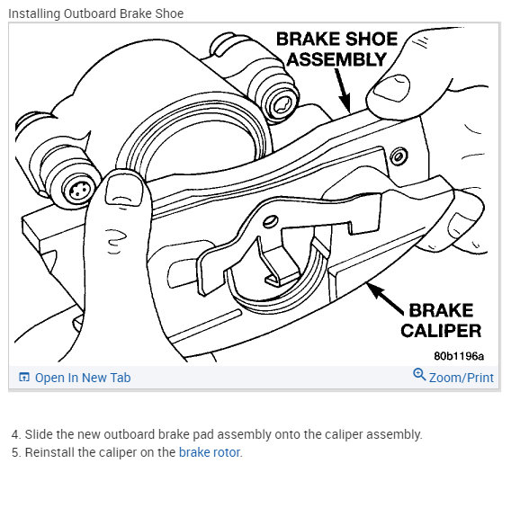

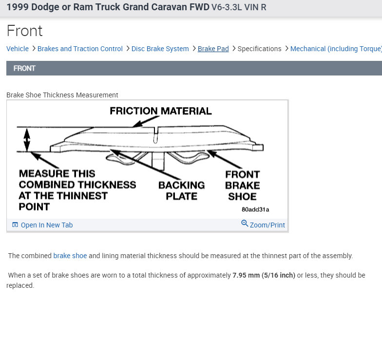

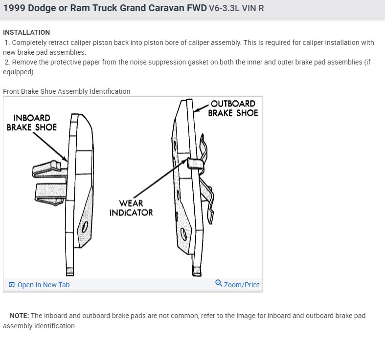

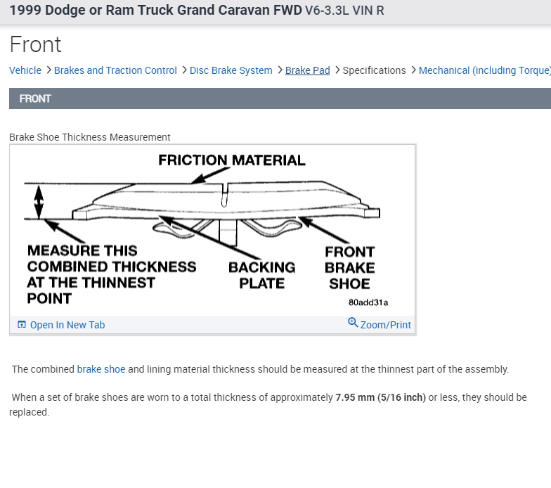

What tools need to replace the front brakes and rotors. Any specail socket needed to my grand caravan
Wednesday, May 6th, 2009 AT 12:06 PM
SQM
  • 6,383 POSTS
Replacing the brake pads and rotors can be done using basic hand tools.
You will have to have a jack and a stands to be able to raise the vehicle. You will also need a caliper piston compress tool or a large C-clamp.
Remember to remove the brake fluid reservoir cap before getting started.
Here is a helpful guide:
