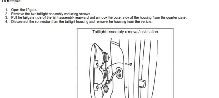

How do I replace the brake/turn signal lamps on this car?
Thursday, April 29th, 2010 AT 1:07 PM
INTERNETMECHANIC
MECHANIC
700 POSTS
Do you have an owners manual, the info should be in the manual?? As far as the tail lamp assembly, I found this.
