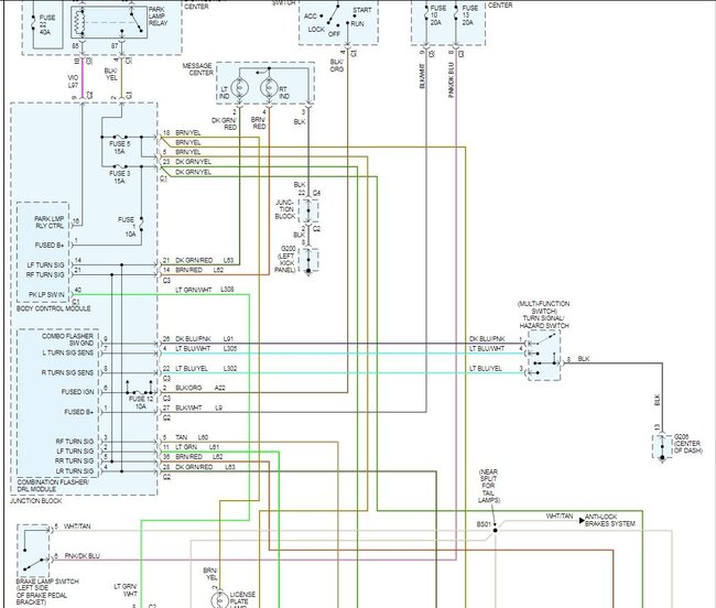

I have no brake lights, but the tail lights and signals still work, what could be the problem

This uses a very basic circuit and the turn signals are not part of it. It powers from fuse #13 20amp and then goes through the brake light switch so you just need to do some testing at the brake light switch and see if you have power coming in all the time and going back out when the brake is applied.
This guide will help you test the circuit
See the wiring diagram below

We have checked that and even the bulbs they work, tail lights work.

If you have already checked it, tell me where you have power and where you don't and what color the wires were.
