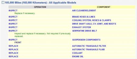

I have a 99 dodge gr caravan with 102k on it an am planing to take a long trip with it @ 3000 miles. It runs well and has been reasonably well maintained, but I have a question as to what type of preventative or other maintenance should be done prior to this long drive. Any help or suggestions would be appreciated.
Thanks,
Tim

I suggest checking out the list below BEFORE the trip. Also don't forget to check your tire pressure and tread, ensure lug nuts are tight as well. May be a good time to check your headlamp, signal and brakelamp bulbs as well.
https://images.2carpros.com/forum/automotive_pictures/261618_Noname_1165.jpg
