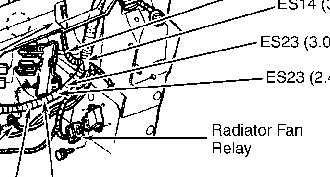

Last night, after turing off the ignition and taking out the key, a fan, probably teh main engine cooling fan, kept running. My battery was dead this AM. Each time today this has continued to happen, requiring a jump, etc.
Taking out which fuse would stop this temporarily, and what can I do long term?

your problem is a faulty radiator fan relay. this picture shows where it is located. its the drivers side front of vehicle. hope this helps
https://images.2carpros.com/forum/automotive_pictures/139033_relay_1.jpg
