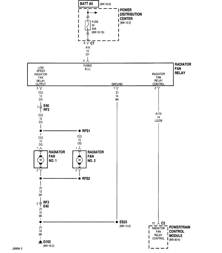

Neither of my cooling fans are working. I have replaced radiator cap, and fan relay. Fans work, I have wired them directly to the battery, and I control them from a toggle switch, although I don't want the fans to burn out so I am driving it sparingly until I can remedy the problem.

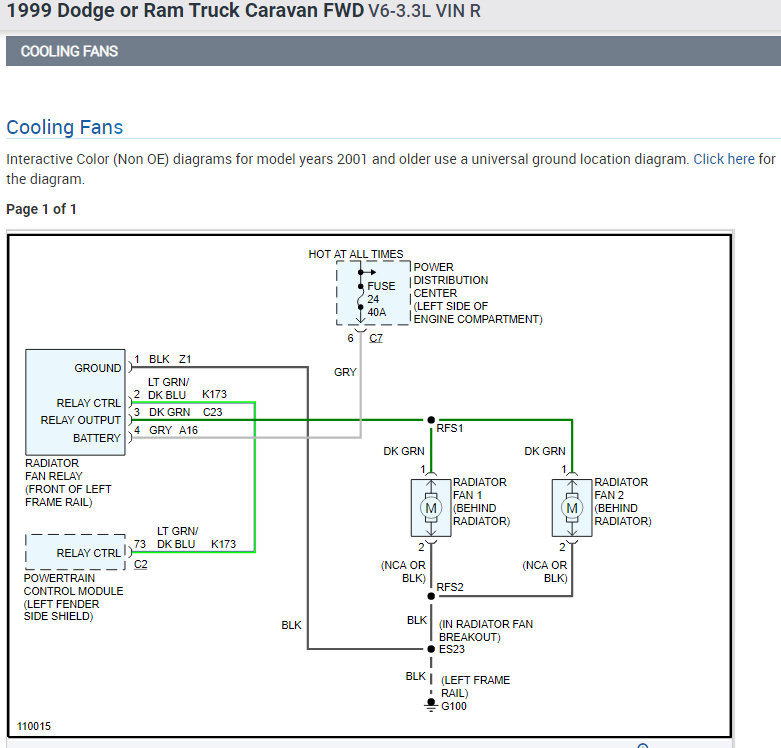

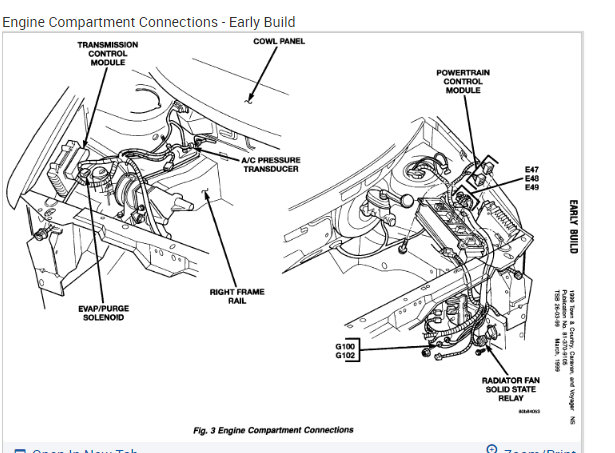

Since you have already verified that you have a good fan motor and good relay.
It sounds like you have a wiring issue with the cooling fan system.
You will have to use a multimeter to trace the wiring for the fan and relay and see where you might have a open or short.
Here is couple of helpful articles on how to check wiring:
I have attached the wiring diagrams for your reference.
