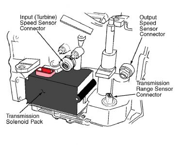

Need codes you can get them by cycling ignition switch on off 3 times ending with the key in the ON position read codes in the odometer area most common speed sensors and or solenoid pack at the side of the tranny similar to this picture good luck Have an automotive repair question! Sign up and ask your automotive question ! https://www.2carpros.com/affiliate/uid/bmrfixit_1_tlid_1
https://images.2carpros.com/forum/automotive_pictures/99387_caravan_tranny_5.jpg
