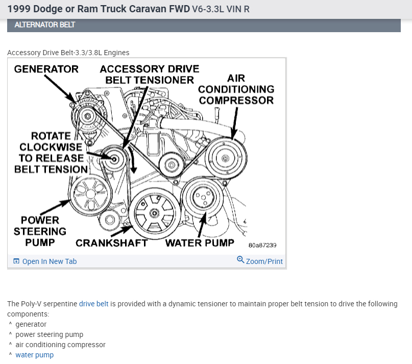

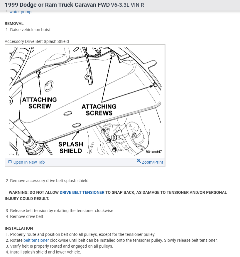

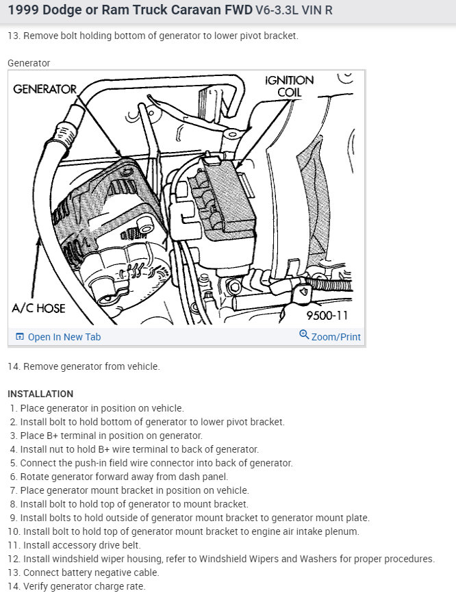

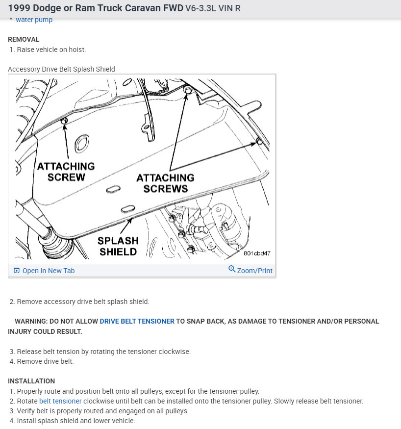

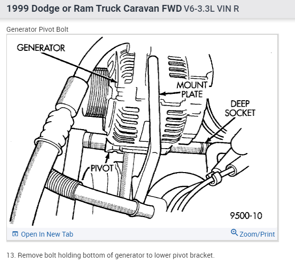

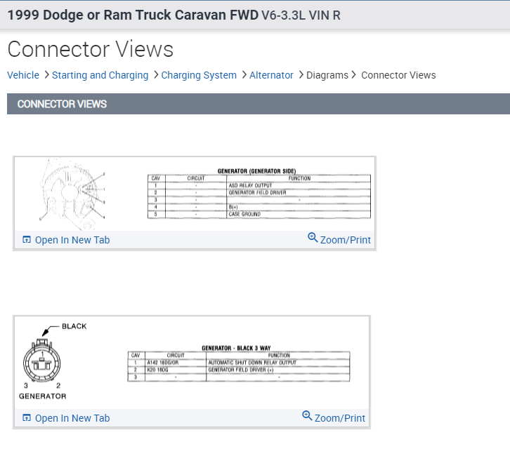

How do you change the alternator on a 1999 dodge caravan? How do you get the tention pully to release to get the alternator off?

To release the tension of the tensioner you will have to rotate it clockwise.
Careful not to allow the tensioner to snap back in place.
Here are a couple of helpful articles:
https://www.2carpros.com/articles/how-to-replace-an-alternator

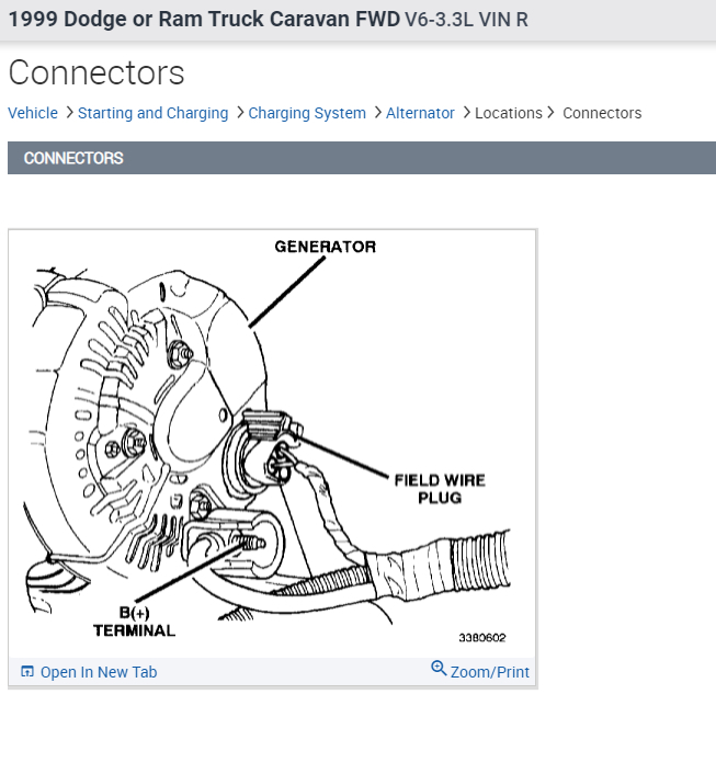

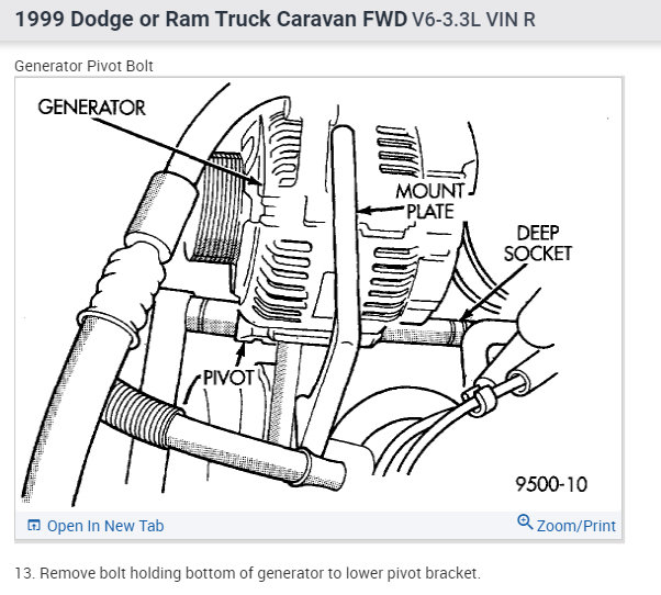

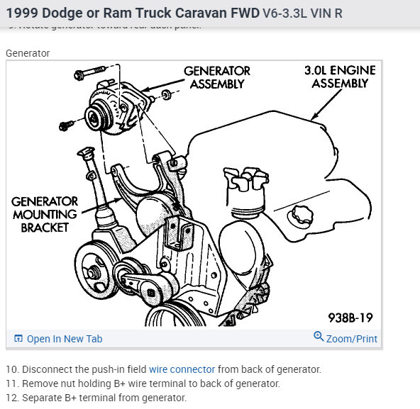

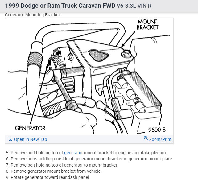

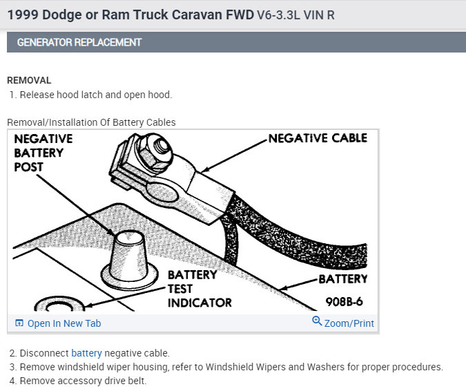

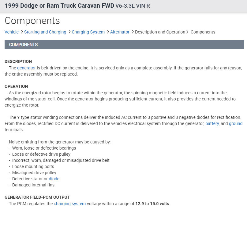

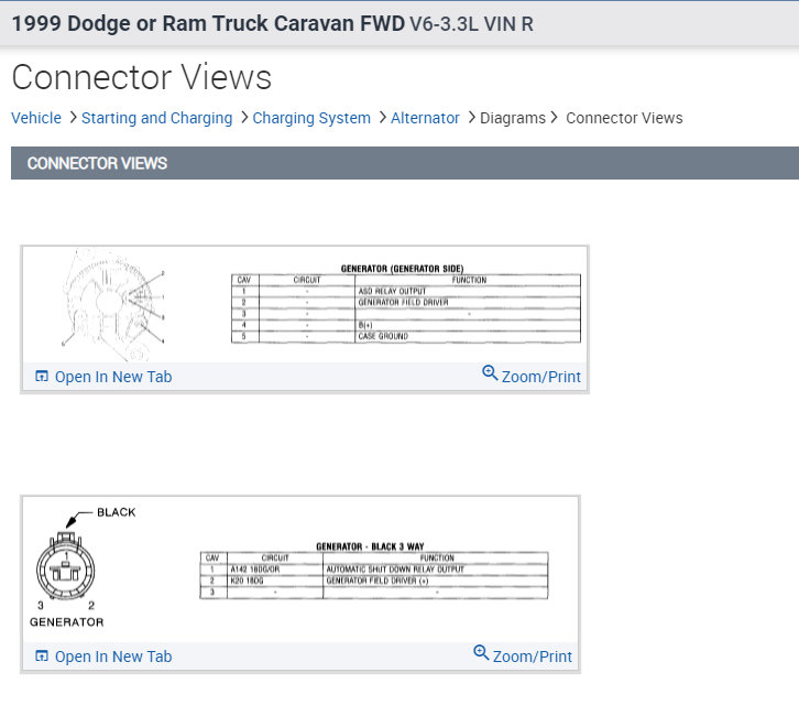

I have attached diagrams of the replacement procedure below.
